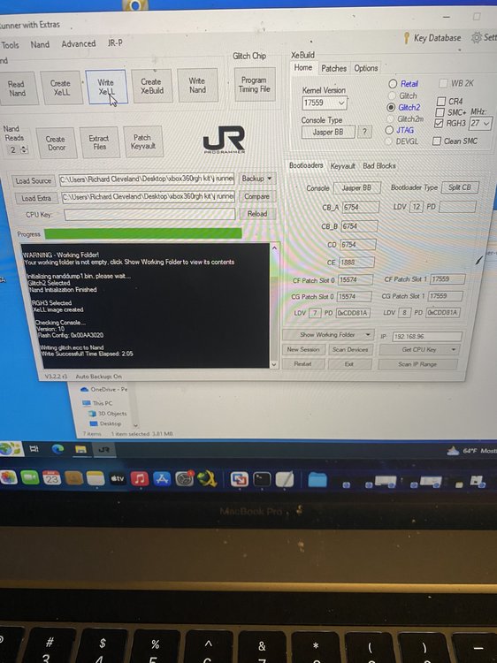

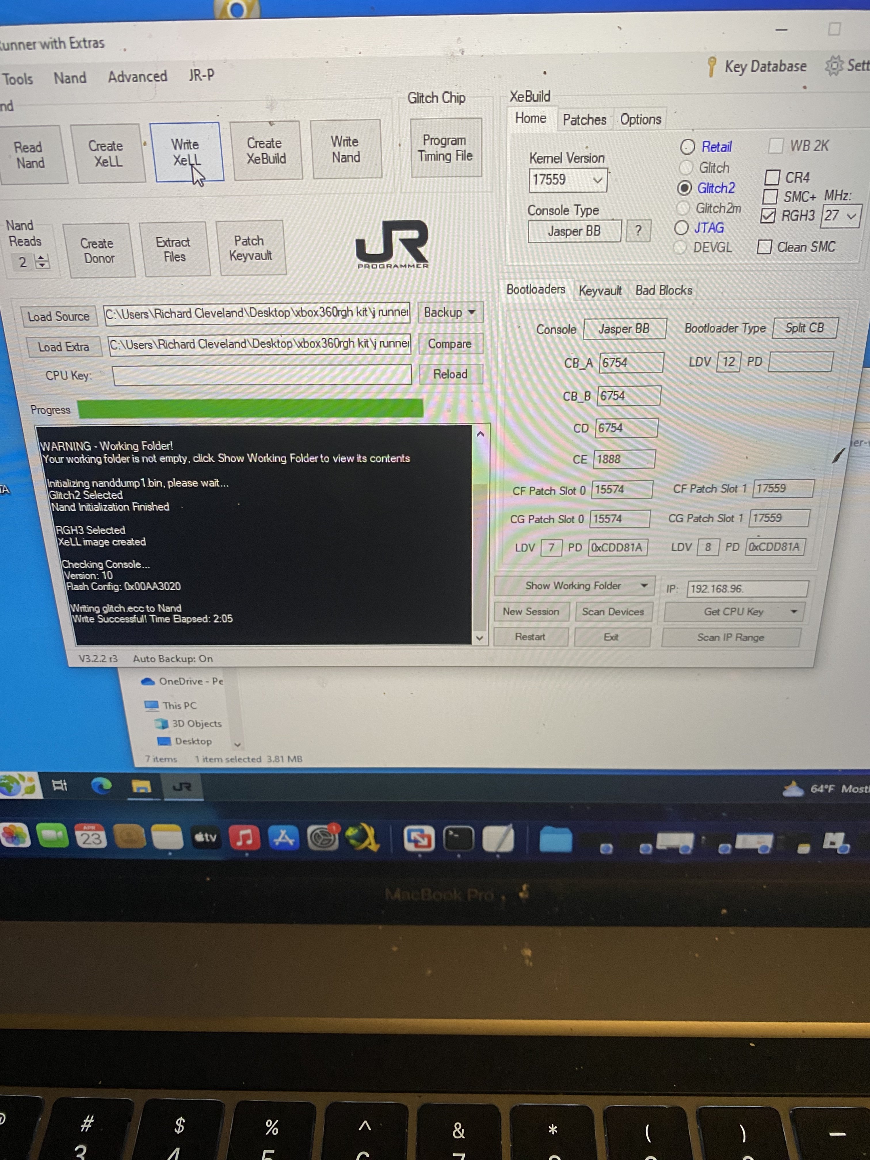

Virus713 0 Posted April 24, 2023 So I did a jasper dump yesterday I got all the way to write xell then when I try to get too xell screen on Xbox nothing shows everything was successful I never get the cpu key and I’m stuck with a black screen no logo of Xbox nothing even after stating over. Both nand dumps are the same and my system still shows in j runner. I had maybe 5 bad blocks in both dumps and I don’t remember if I had 1 in the nand write but both was successful. So I was wondering if there any way to fix this? Is it the bottom wires as there kinda hard without micro… or I bricked .. bricked it? And is there anyway to fix it if it’s just a corrupted dump..also I used JR programmer Thanks! And again never gained cpu key! Quote Share this post Link to post Share on other sites

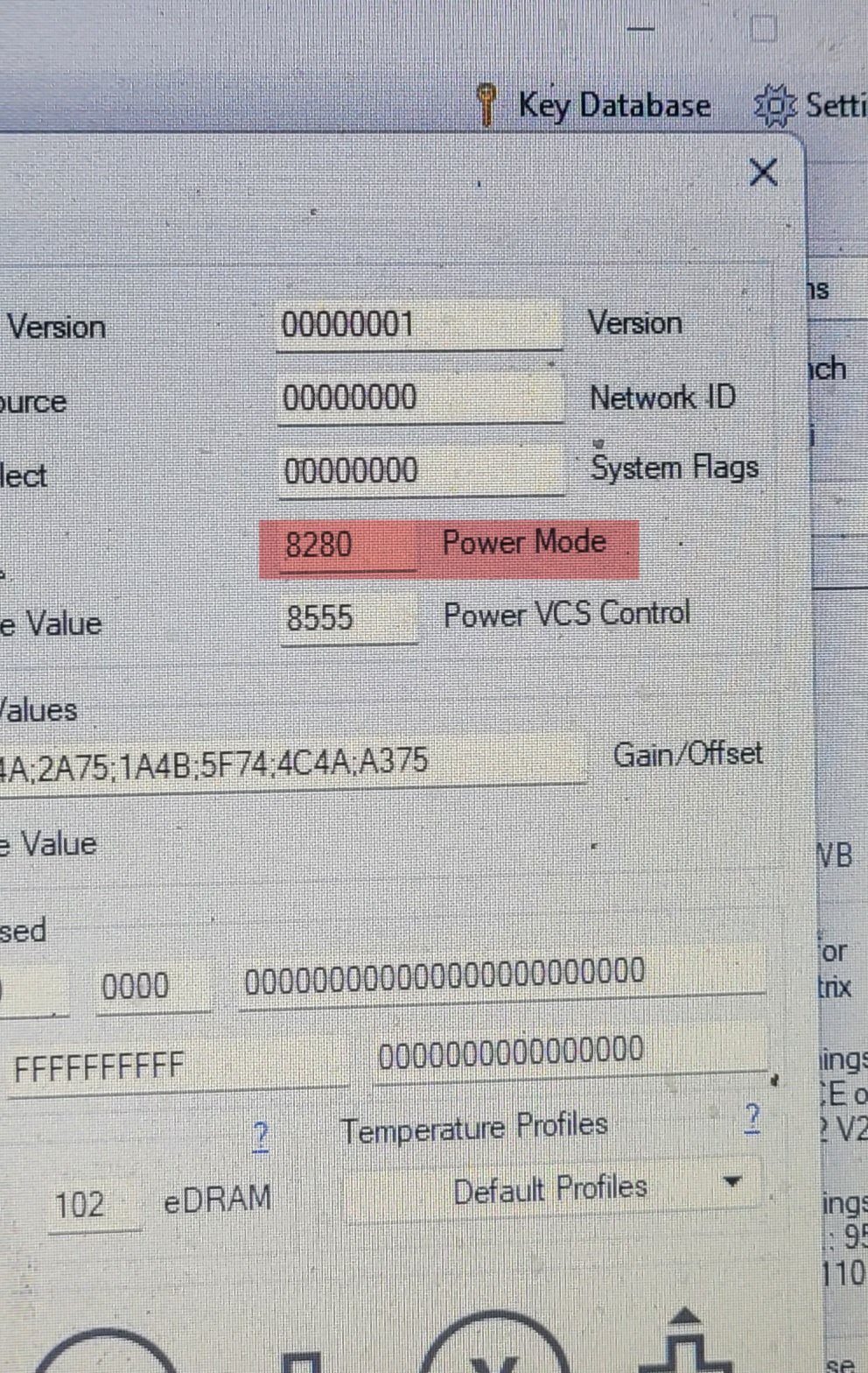

Puppydogpals 0 Posted May 22, 2023 Installed rgh3 on a Falcon, getting instant reliable boots, however I am getting random freezes unless I have fan override at 90% anything less and it will freeze anytime upto 15 minutes later at 90% it Will work OK. I am waiting on xclamp removal tool and mx-4 paste. Someone advised that in change the smc power from 8280 to 8080. Can I do this In the following way using j runner Load up my updflash from my original xebuild in load source, select glitch 2, rgh3 and 27mhz Change 8280 to 8080 using jrunner and save. as in attached picture Click create xebuild Flash the newly created updflash using xell and usb. Will this work and not damage the xell boot, or do I need to start again with with j runner and my original untouched dump?? Quote Share this post Link to post Share on other sites
Octal450 98 Posted May 22, 2023 The fan thing is not related. Btw, I am still alive, the next update is just changed a lot of things so as a result the release is taking longer to be ready. The next release should be in June. King Regards, Josh Quote Share this post Link to post Share on other sites
Puppydogpals 0 Posted May 23, 2023 14 hours ago, Octal450 said: The fan thing is not related. Btw, I am still alive, the next update is just changed a lot of things so as a result the release is taking longer to be ready. The next release should be in June. King Regards, Josh I reflashed with 8080 and used stock temp values and no more freezing even though its now hitting higher temps. It hitting 75 on dram before it would freeze around 63, that's why i originally thought it was heat related but its not. Would the fans running at a high speed alter voltages across the board and fix / mask the underlying issues that altering the power mode settings do. What does altering the power mode down by 200 effectively do to to the system and negateb freezing on falcons? Quote Share this post Link to post Share on other sites
