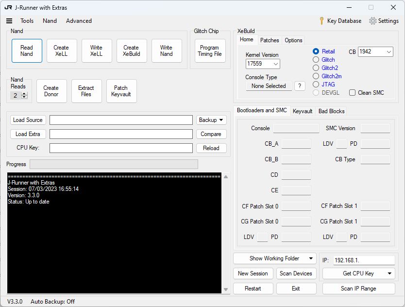

Octal450 77 Posted November 21, 2020 Hi, LATEST VERSION: 3.1.5 - 5/20/2022 Based on there being some interest I decide to post my J-Runner with Extras here to provide for y'all. So what has it? - Fully working in Windows Vista, 7, 8.x, 10, and 11! No more crashing! - 17559 Dashboard, 3.21 Dashlaunch, and 1.21 XeBuild support - Native FTDI Support (xFlasher and squirt) - SMC+ Support (Super fast glitch cycles without false success resets) - RGH3 Support - Added 6717 and 9199 Dash Support for JTAG, GLITCH, GLITCH2, R-JTAG (THX @SGCSam!) (Supported motherboards only) - RGH1.2, S-RGH, R-JTOP timings added to Program Timing File menu (see picture) - Timing Assistant - Easy Donor Nand Creator - Tweaked XeLL RELOADED: ----- Displays Console LDV ----- Displays Motherboard type ----- Displays serial number for console and board ----- Fixed USB refresh bug - Cleanup the UI in general, loads of usability and quality of life improvements - Loads of various bugfixes all over the place, rewritten code for a more stable experience - DEVGL Build Support (doesn't include any keys, find them yourself) - Bigffs Build Support - AND LOTS MORE! System Requirements: - x86 based Windows PC (i386 or amd64) - Windows Vista SP2 or later - dotNET Framework 4.5.2 - USB 2.0 port for hardware devices Screenshot: Download Release Kind Regards, Josh 7 7 1 1 Quote Share this post Link to post Share on other sites

jakke 0 Posted February 3, 2021 Updated the original Nand on a Trinity with Demon and Xecuter CR3 Pro to 17559 from Xbox Live, from 16xxx something, after that the console didn`t glitch anymore. Flashed the Demon Nand to 17559 with J-Runner 2.9.7, unfortunately I also used the feature ”Glitch chip - Program Timing File”. Something tells me this was not a good thing to do with a Xecuter CR3 Pro chip? I assume this is equal to ”Program Coolrunner” in other J-Runner releases? Is it bricked or is it possible to restore the CR3 to factory firmware? Quote Share this post Link to post Share on other sites
Octal450 77 Posted February 4, 2021 If you flashed the Xecuter CR3 PRO, you need to reconfigure the DIPS. Sorry, I have no expirience with S-RGH on that chips, so I don't know what the DIPS should be. Maybe all off. "I assume this is equal to ”Program Coolrunner” in other J-Runner releases?" Yes, except mine uses the latest timing files available, not the outdated methods. Kind Regards, Josh Quote Share this post Link to post Share on other sites
