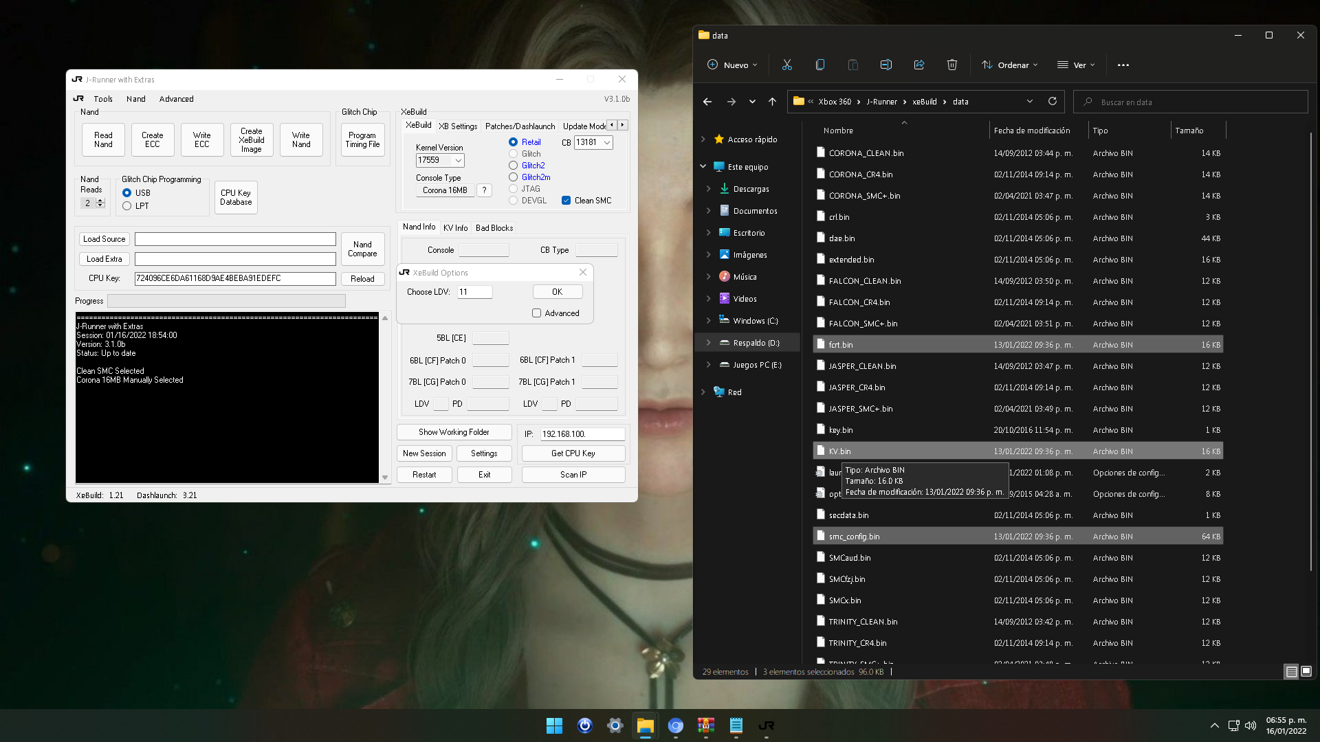

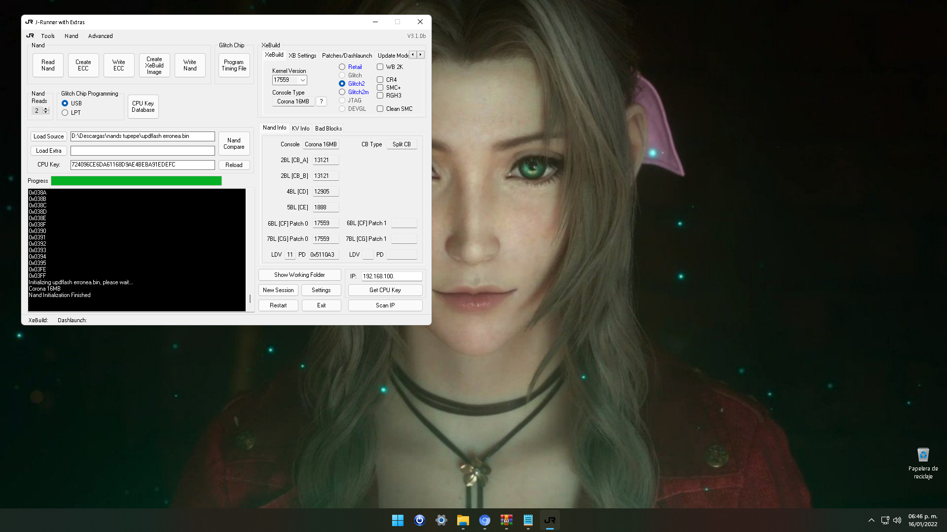

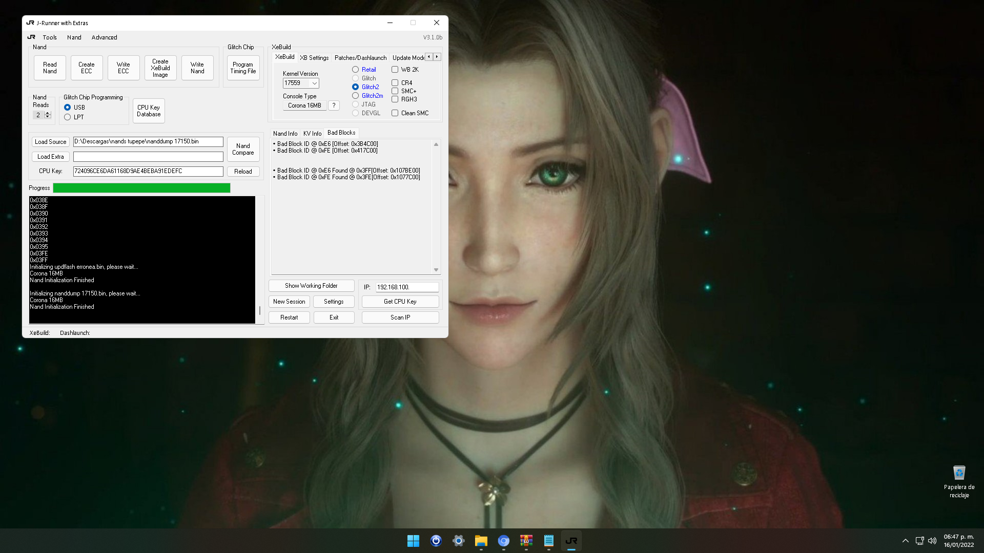

Eruil 3 Posted January 14, 2022 On 1/1/2022 at 1:38 AM, Octal450 said: My pleasure, thanks for reporting it! Happy New Year! Kind Regards, Josh Hello Josh and happy 2022 thank you for your awesome work . i hope that this bug report may be of interest to you . i tried to create a new retail nand without bad blocks using a glitch nand with bad blocks with the "create an image without nandump.bin " using the extracted nand files but i see that you removed it in 3.1.0.b . i created one using your software but retail nand keeps the bad blocks . i used another jrunner to complete the task. hope it helps in any way Quote Share this post Link to post Share on other sites
Octal450 93 Posted January 14, 2022 @Eruil would you be able to send me the dump so I can check? Also - you can use SHIFT+click to access the old system. Kind Regards, Josh Quote Share this post Link to post Share on other sites
Octal450 93 Posted January 14, 2022 On 1/10/2022 at 2:36 PM, willerson said: @Octal450 SMC+ affects RGH3 or it is a different thing? i should select SMC+ when building RGH3 or not? thanks for the software. Stop it, get the update You will quickly find, that you cannot select SMC+ and RGH3 at the same time. RGH3 has it own SMC. Kind Regards, Josh Quote Share this post Link to post Share on other sites
Eruil 3 Posted January 14, 2022 13 hours ago, Octal450 said: @Eruil would you be able to send me the dump so I can check? Also - you can use SHIFT+click to access the old system. Kind Regards, Josh no prob . i made it to another coleague in EOL forum ;D . i recompiled a bad block glitch nand to a retail with no bad blocks https://mega.nz/file/BU1GxLbI#VrYSaxaZ6ns1dSRE4_OxqWSvnBoILd1lMBRwXGooa6I i tested in your jrunner version. i selected clean smc and i pressed the left click + shift in the "create donor nand option " . it worked . thanks mr davidson ;D Quote Share this post Link to post Share on other sites
djon 40 Posted January 15, 2022 why in the new J-Runner with Extras Session: 01.15.2022 16:27:20 Version: 3.1.0b didn't add bootloader 13182? for dashboard 17599? Quote Share this post Link to post Share on other sites
Octal450 93 Posted January 15, 2022 22 hours ago, Eruil said: no prob . i made it to another coleague in EOL forum ;D . i recompiled a bad block glitch nand to a retail with no bad blocks https://mega.nz/file/BU1GxLbI#VrYSaxaZ6ns1dSRE4_OxqWSvnBoILd1lMBRwXGooa6I i tested in your jrunner version. i selected clean smc and i pressed the left click + shift in the "create donor nand option " . it worked . thanks mr davidson ;D Thanks friend. I will investigate and make a patch release later this month. 4 hours ago, djon said: why in the new J-Runner with Extras Session: 01.15.2022 16:27:20 Version: 3.1.0b didn't add bootloader 13182? for dashboard 17599? Sorry, I have absolutely no idea what you are trying to tell me. 13182 is placed by check WB 2K ok? Kind Regards, Josh 1 Quote Share this post Link to post Share on other sites
Octal450 93 Posted January 16, 2022 On 1/14/2022 at 12:34 AM, Eruil said: Hello Josh and happy 2022 thank you for your awesome work . i hope that this bug report may be of interest to you . i tried to create a new retail nand without bad blocks using a glitch nand with bad blocks with the "create an image without nandump.bin " using the extracted nand files but i see that you removed it in 3.1.0.b . i created one using your software but retail nand keeps the bad blocks . i used another jrunner to complete the task. hope it helps in any way @Eruil Can you tell me more how to reproduce? I loaded your dump, and used the donor nand wizard and the output has no bad blocks: That is because "create image without nanddump.bin" and "Donor Nand Creator" both do not use the original dump, they do a fresh image. Please provide me steps on how to reproduce this so I can fix it! Kind Regards, Josh4 Quote Share this post Link to post Share on other sites

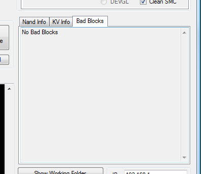

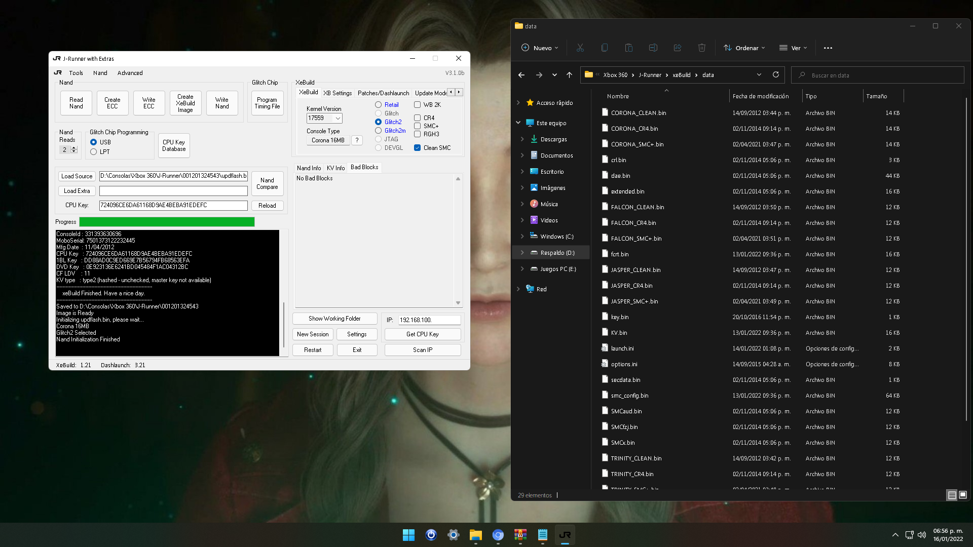

Eruil 3 Posted January 17, 2022 4 hours ago, Octal450 said: @Eruil Can you tell me more how to reproduce? I loaded your dump, and used the donor nand wizard and the output has no bad blocks: That is because "create image without nanddump.bin" and "Donor Nand Creator" both do not use the original dump, they do a fresh image. Please provide me steps on how to reproduce this so I can fix it! Kind Regards, Josh4 i used the nanndump 17150 with badblocks and i tried to create another with 17559 dash in your jrunner version . the result was an updated nand with same bad blocks . i extracted files (kv.bin, fcrt.bin, etc...) and i compiled a new retail one with jrunner 0.8 benmitnick using the "create a new nand without nandump" . then i finally used that retail with no bad blocks to create a rgh 3 17559 nand . then i tried what you said about shift + left click in the donor nand option copying extracted files (kv.bin , fcrt.bin, etc) to /xebuild/data and selecting "retail" with "clean smc" options. it worked . i thought that you had removed the "create an image without the nanddump" completely . im glad that its not what i thought ;D Quote Share this post Link to post Share on other sites
Octal450 93 Posted January 17, 2022 Hi @Eruil I understand that - but I cannot reproduce what you are saying where the resulting image has bad blocks. When I made it with the donor creator, it had no bad blocks! So please provide me to reproduce the image that is having bad blocks. Kind Regards, Josh Quote Share this post Link to post Share on other sites
Eruil 3 Posted January 22, 2022 On 1/17/2022 at 5:38 AM, hunters-fox said: delete dude , you never sent the cpukey . we need updflash.bin (or any nand dump) + cpu key . cpukey its MANDATORY to create another nand to octal. no prob dude . i think that you only need to ad in shortcuts the info about shift + left click to make new nands. i tested it without any problem ;D Quote Share this post Link to post Share on other sites
Octal450 93 Posted January 23, 2022 @Eruil Yes it is, because I want to remove the old way and replace it with the Wizard way. So please, provide me the steps! Perhaps you did not use the wizard completely? For me, no bad blocks. Please advise. Kind Regards, Josh Quote Share this post Link to post Share on other sites

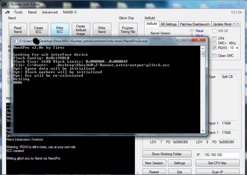

gonza3 0 Posted January 28, 2022 Hello. Using MTX SPI NAND Flasher V1.0, J-Runner with Extras 3.1.0b (Windows10 64bit pc) could not write ECC of Jasper 16mb. There is a block that says Timed out when writing, and the xbox 360 won't turn on. ECC could be written on J-Runner v0.3 Beta (8) (Windows7 64bit pc). Strangely, another Jasper 16mb was able to write ECC with J-Runner with Extras 3.1.0b (Windows10 64bit pc). Even if the console version is the same, it may or may not be writable. The following can be written with J-Runner with Extras 3.1.0b (Windows10 64bit pc) so far. Falcon, Trinity, Trinity 4gb, Corona v1 If you can, please take measures. Quote Share this post Link to post Share on other sites
Octal450 93 Posted January 28, 2022 Hi, @gonza3 We don't know why yet. The working J-Runner version is not reverse engineerable by us (obfuscate) and the source code has thsi fault. Go to NAND-X menu and enable Matrix Flasher Mode. Then use Matrix Flasher drivers in the install. From there it will work. Note: its intermittant. If you connect everything and then open J-Runner, it seems to work. Kind Regards, Josh Quote Share this post Link to post Share on other sites

Octal450 93 Posted January 31, 2022 2 hours ago, Eruil said: the nanddump 17150.bin file that i uploaded was a corrupt nand (with badblocks) . to fix it i had to extract files and i tested with shitf + mouse left click and with the new "create donor nand option" . both worked fine . i checked the "clean smc " box to make it work . ;D . if you use that nanddump 17150.bin file and you select "retail" + "clean smc" and then you use the "create xebuild image" option it will create a new updflash.bin with the same badblocks . i thought that jrunner remapp badblocks automatically but its better if you create a new clean nand.bin. greeetings from mexico ;D Very well, thank you for the updates. Yes, Create XeBuild will NOT do anything, it will keep it. Very great to hear the New Donor Nand Creator worked properly. Greetings! @hunters-fox You are need to follow the tutorial, then he will show, I promise. If is not showing, you are doing something wrong! Kind Regards, Josh 1 Quote Share this post Link to post Share on other sites
