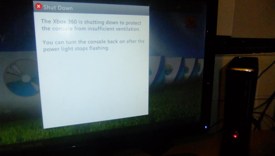

I changed the speed of my fan on my Xbox 360 s (Trinity) to 70% a few days back, then after powering off the console going back onto F3 and changed it back to Auto. Its quite possible that F3 may have saved a setting somewhere where the fan speed changed be from 70 to 0.
When I powered the xbox on, the fan did not come on, at all. I've no idea what caused this, i deleted F3, reinstalled, no fix, so I just flashed the dashboard again and that fixed it.
Of course, I didnt see the fan didnt come on, so took it off, instaleld new thermal paste then after powering up the console with the case open I noticed the fan didn't spin.
Not sure if this glitch was on F3 or other but if you change your fan speed, keep an eye on the temp.
Posted Image

Flash your console with a nand image that last worked correctly.If that doesn't fix it then i would look into a replacement fan
Jeje le tech    16
Check dashlaunch settings too ....
it's easier to manage temp via dashlaunch ....
otherwise your fan might be dead ...

I thought it might be dashlaunch too, I just reflashed the nand and the fan is fine.
This post is really to give others the heads up if they adjust their fan settings and the F3 team if it was a FSD glitch.

F*ck knows what it was mate, issues resolved. Used Xell to flash 15574 dash and it worked. Hasn't stopped since, won't be touching the fan settings...ever :)

What i can say is that F3 does not permanently change your fan speeds at all. We only change it on the fly. So any change made in F3 to Fan speeds is undone when you restart.
Now that being said i HIGHLY recommend setting temp thresholds to control your fan speed and NOT using F3 to do it.
Making the fans spin faster all the time can cause extra wear and possibly more heat being generated when its not necesary, using temp thresholds will have your xbox running at the temperature you want all the time and the xbox can decide how fast to spin the fans. Honestly the Fan speeds in F3 are a legacy thing from before we could do it with dashlaunch easily.

I have to say that what i mean is it is undone on COLD BOOT. If you don't load F3 it doesn't change your fan settings. Loading F3 will again change them, but it is a memory change not a nand change.
As for removing it from F3 i am not sure if we will or not, but honestly temp thresholds is a LOT better for your xbox.
