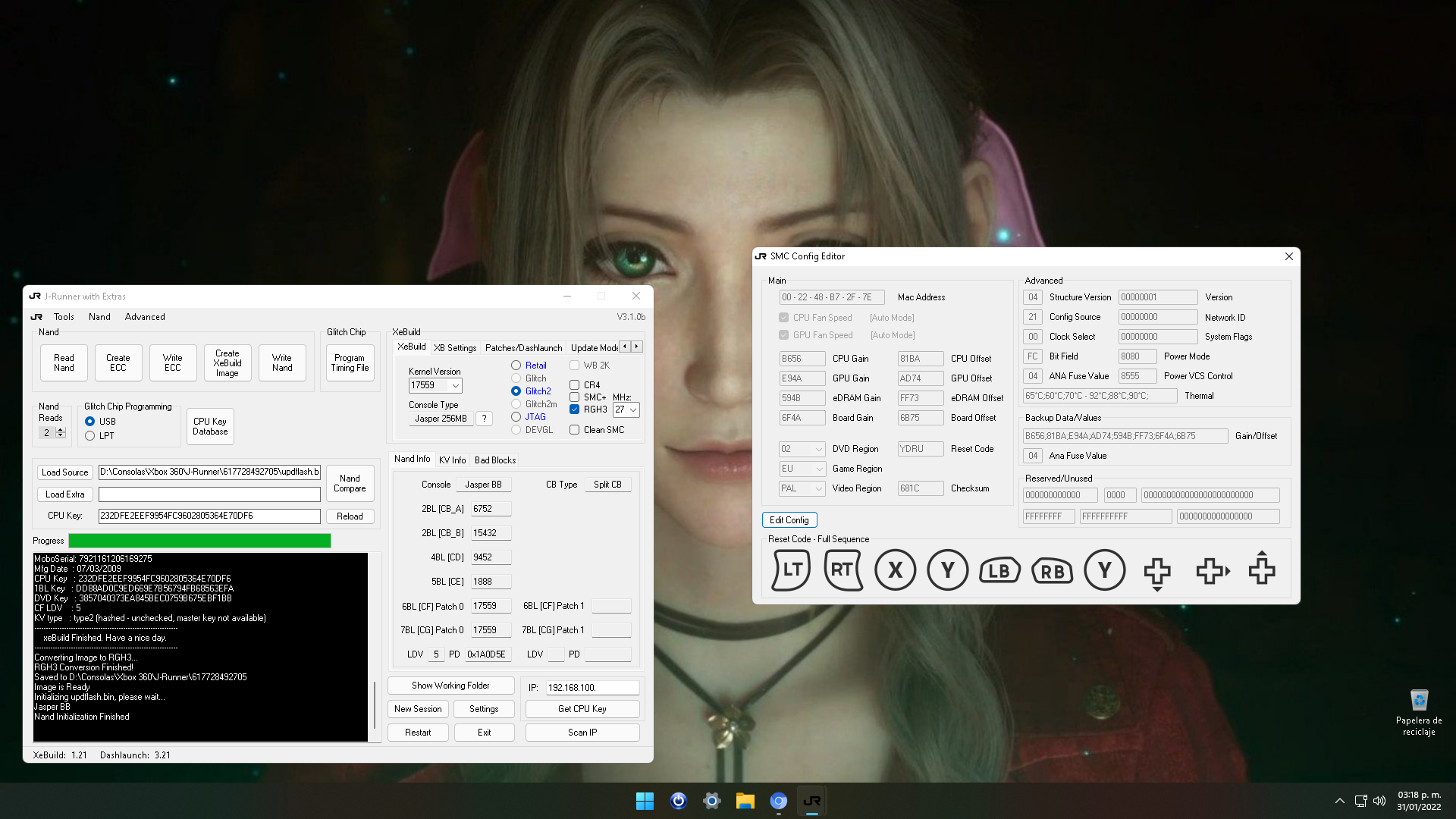

i made the steps i wrote to you . there was no problem (look at power mode and power vcs control data)  :
@Octal450 :  the info about how to reset parental control its very usefull ;D

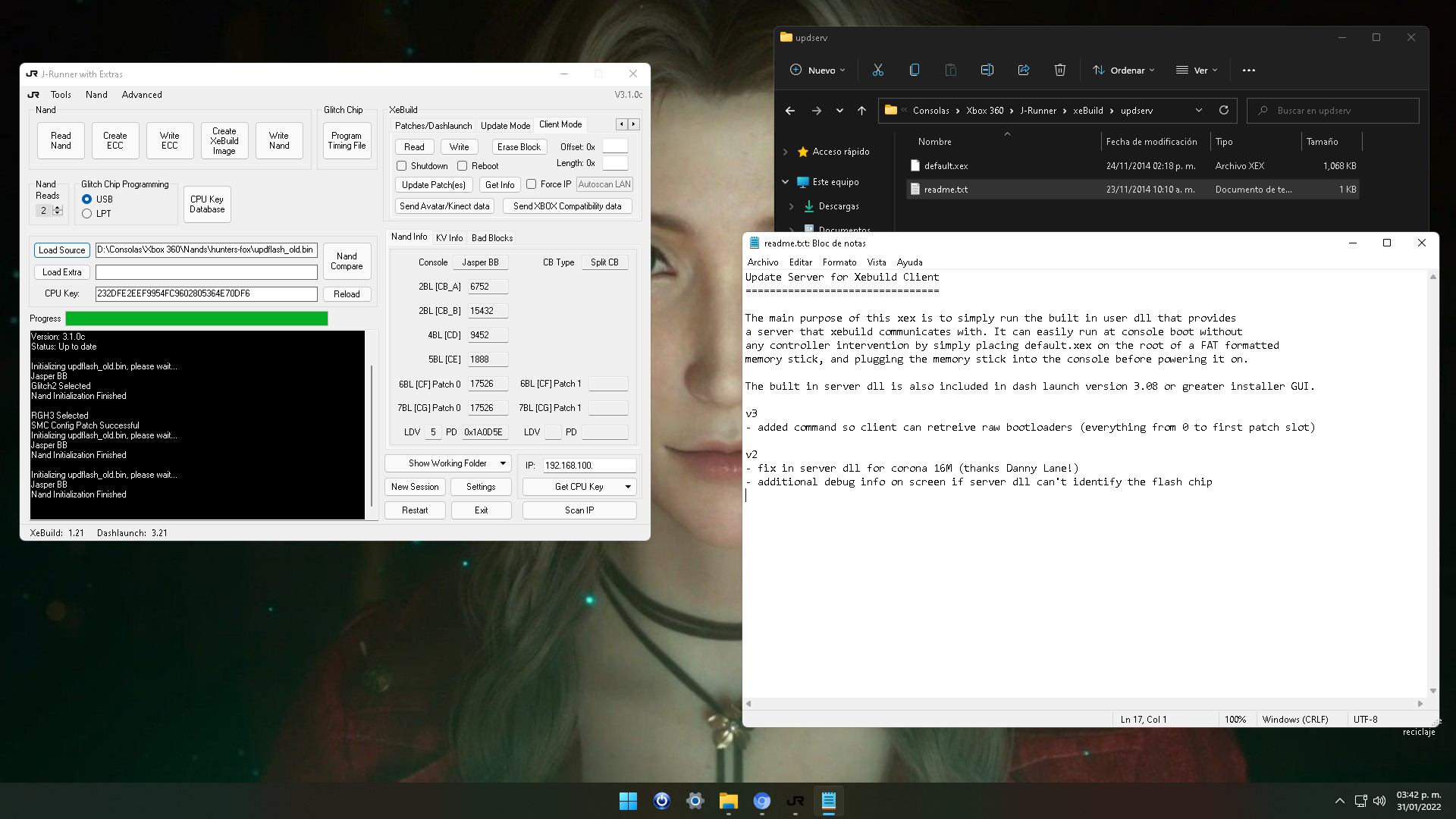

yup. ive already downloaded it . updserv its still v2 . i replaced it with updserv v3 xex file :D

3 minutes ago, Octal450 said:
@Eruil
You're right, oops.
I will serve v3 next update.

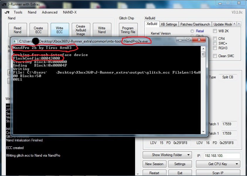

Hello @Octal450
After some days I finally tried to write from corona using nandpro2e, but without success. This is the result...
But when replacing the version of nandpro with NandPro2b_Armv3, the write is done correctly...
For now I will continue using that version.

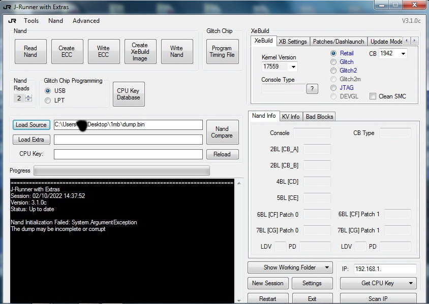

I'm also sorry to report that the latest version contains a bug trying to recognize 1MB (first 50 blocks) dumps of big block jasper. This is the bug...
With earlier versions of J-Runner this problem does not exist.
I know that dumps of this size are not common, but there are still users who read their nands by LPT. And to speed up the process, they read 1MB and then from xell they extract the rest of their nand.
I hope you can check these problems.

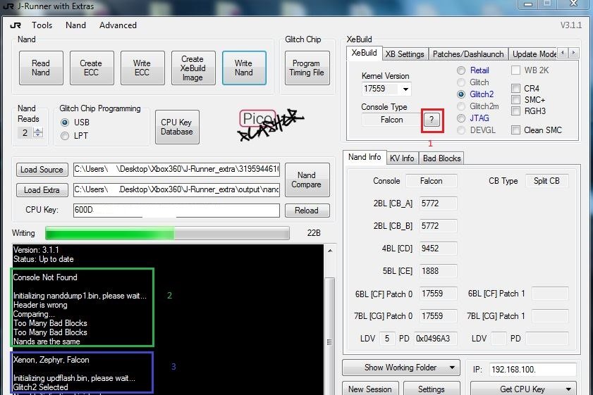

Hello,
although I am not Octal450, I will try to help.
I have been using picoflasher for a few days, and I can say that you have to be careful when reading nands, because if the correct installation is not verified in the console, we will get corrupted readings. Verifying the installation is not really difficult, just follow these steps.
Before trying to read the nand, press the button that is in box 1
a bad installation will show messages like the ones in box 2:
"Unrecognized Flash Config": Indicates that some connected nand is detected, but the system is not identified. Try to check the wiring.
"Console Not Found": Indicates that it does not detect anything connected to the picoflasher. Try connecting the power supply to the console first and then the picoflasher to the computer. or the picoflasher to the computer and then the power supply. and if this does not work check the wiring.
"Corona 4GB (EMMC not connected)": similar to "Unrecognized Flash Config" but in Corona 4GB
As seen in box 2, the wrong detection of the console will generate corrupt readings.
But if pressing the button in box 1 correctly detects the console, the type of console detected will be displayed. like Box 3, these are:
"Xenon, Zephyr, Falcon"
"Jasper 16MB, Trinity"
"Jasper 256MB"
"Jasper 512MB"
"Corona 16MB"
"Corona 4GB"
When the verification is correct, the readings will also be correct.
