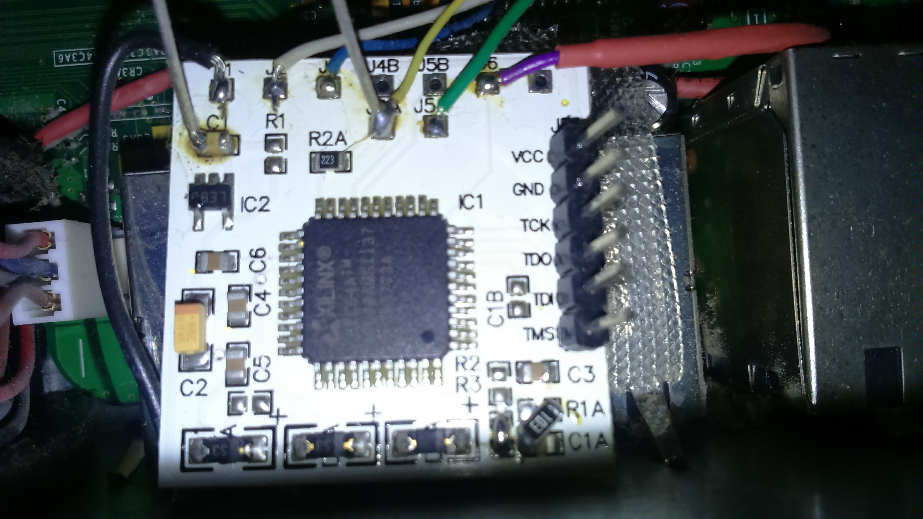

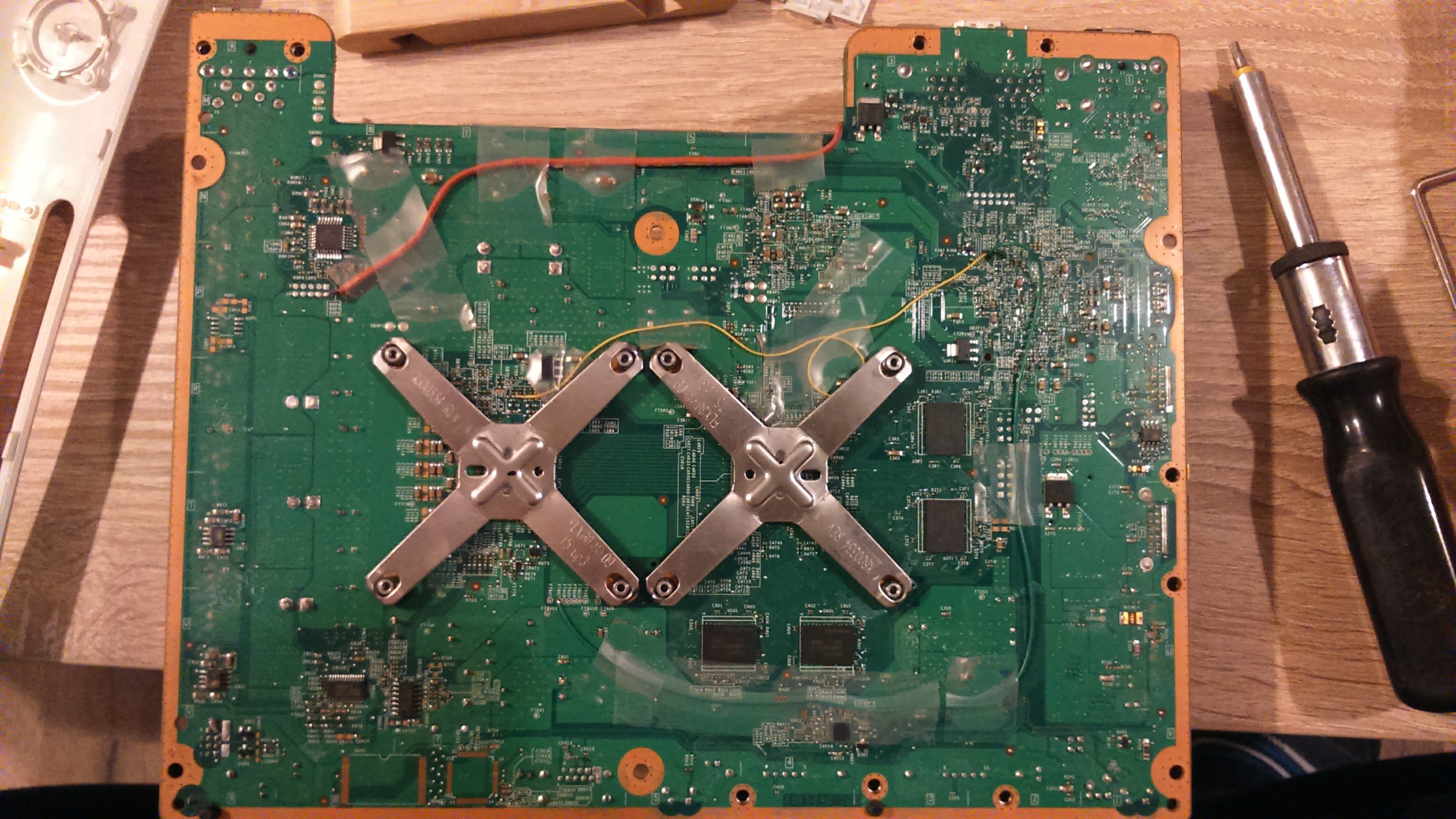

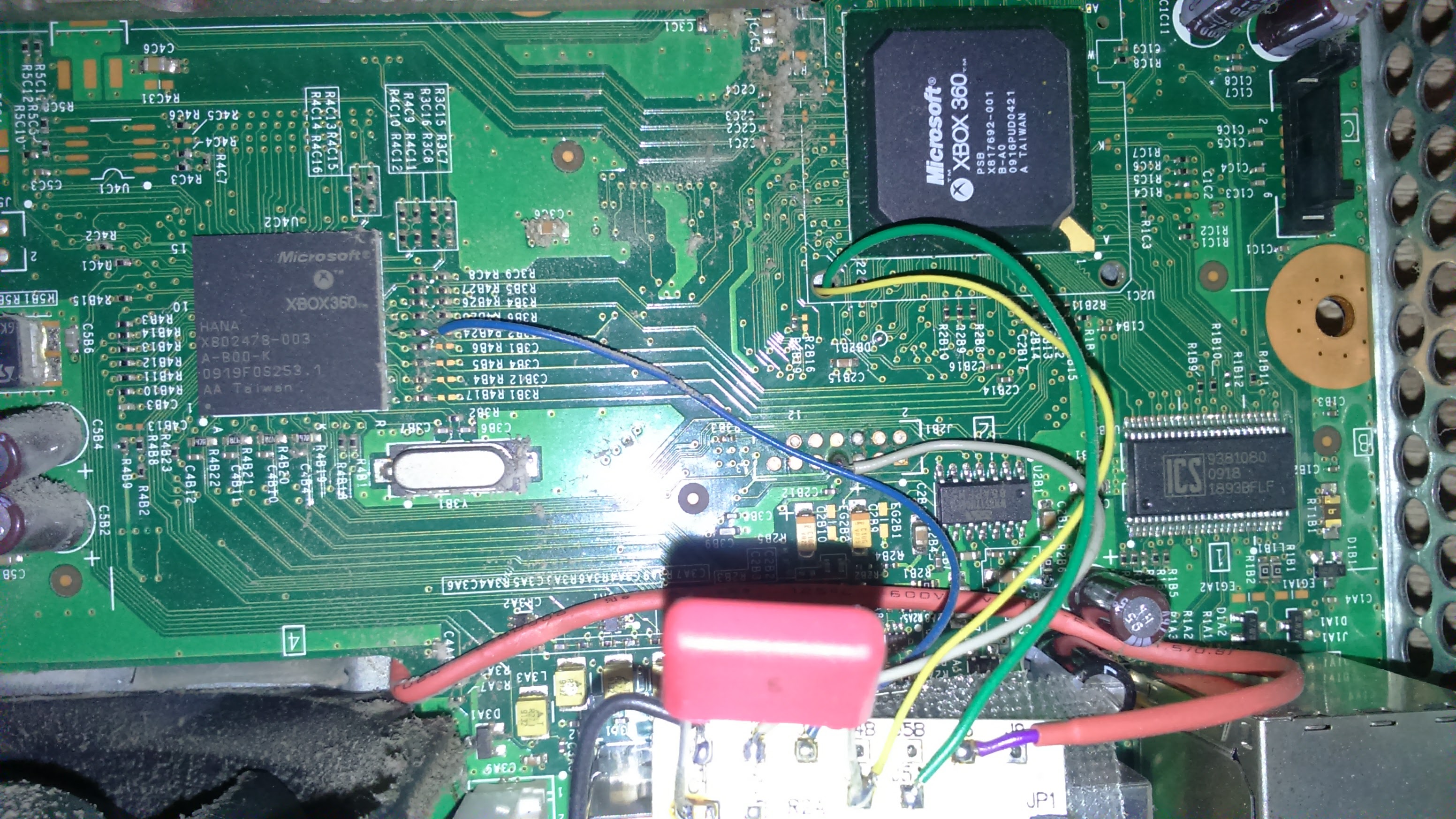

bogdanval 16 Posted November 28, 2017 It's a jasper, RGH1 (if I remember -I have somewhere a swizzy's xebuildgui screenshot...) I'll upload some glitch recently made photos... I'm not shure what "cpu_pll_bypass cleaner" means that I have to check all solders (have in plan that) or ... anyway I didnt know whitch wire cpu_pll_bypass is. Next step is to try aurora with flash... here's the photo... sorry, but I didnt know how to hide... (there is no "hidden content" option in editor?) Quote Share this post Link to post Share on other sites
gavin_darkglider 1563 Posted November 28, 2017 CPU_PLL_BYPASS is the yellow wire. I am not familiar with that chip, but jaspers were notorious for needing the cleaner so they didnt freeze and booted stably. Quote Share this post Link to post Share on other sites
bogdanval 16 Posted November 28, 2017 OOO MM GGG !!! I see what "cleaner" means help me with this... what is the idea behind wiring.... what are rules to follow.... If I rewire the yellow one (keeping that loop) beneath those 2 X from heaters it's ok ? On the another hand, I have pretty much time on boot (5-10 sec). My though was "HDMI handshake" was guilty but now... Quote Share this post Link to post Share on other sites

bogdanval 16 Posted December 2, 2017 Update... I put another cap beside existing one and now there is about 68n... boot time ~ 4sec. But strange thing I've discovered... (strange are IT ways) I put aurora and NFSMW on a stick... if network cable was plugged in console freeze -no matter when; if not, I was able to play more than 1h... else doesn't matter if the ip was static or dynamic the fact was the same: it freeze at a time. Did you encounter same behavior on another consoles ? Next step.... I want to go to a friend to try on he's network to see if I have same behavior... I'll try to upgrade... L.E. there is another log other than that from aurora ? Quote Share this post Link to post Share on other sites
