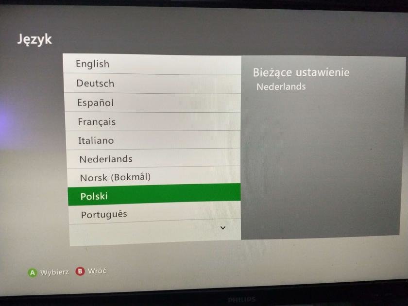

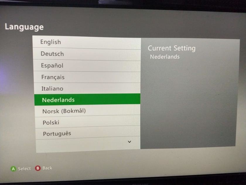

Fien 0 Posted February 1 Yesterday I used J-Runner with Extras 3.2.2 r2 to do the RGH3 on a European Xbox 360 S with Trinity board. It all goes well, except that the dashboard is the newest version (2.0.17559.0) after RGH3 and it's impossible now to use the Dutch language in the dashboard. Before the RGH it has a older dashboard and was set to Dutch. Now after RGH I can change to Dutch in the settings, but the dashboard is still displayed in English, even after a reboot. There's a same problem with Norsk language. But other languages like Polish works fine. I've already formatted the memory and run the initial setup without any change. Is this somehow a bug or is the newest dashboard not supporting Dutch? So if I select Dutch, everything is still in English: But if I select, for example, Polish, everything will change into Polish: Quote Share this post Link to post Share on other sites
Octal450 95 Posted February 1 I'll look into this. Wouldn't be a JR bug, but possibly an issue with XeBuild or 17559. J Quote Share this post Link to post Share on other sites
Fien 0 Posted February 2 It seem to be normal behavior 😮 Someone told me to install the "avatar update" (SystemUpdate_17559_USB.zip) to fix it. I tried it and the Dutch language is displayed again 😀 Somehow not all languages are standard included and comes with the update? Quote Share this post Link to post Share on other sites
Octal450 95 Posted February 2 OK, thanks for the update. Seems to make sense. Kind Regards, Josh Quote Share this post Link to post Share on other sites

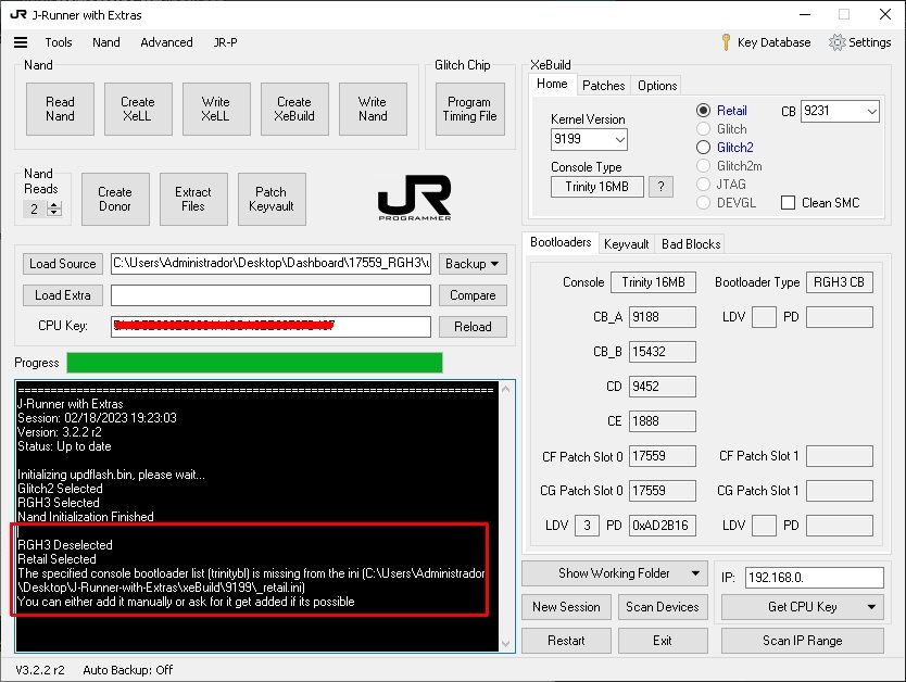

xtremeroboz 0 Posted February 19 Thanks for share. I have a trouble creating a xebuild RETAIL with kernel version 9199 for trinity console, can fix this error? Thanks for you time. Quote Share this post Link to post Share on other sites
Octal450 95 Posted February 19 Hi, The retail thing is not there yet. Maybe I'll try it if I get a moment to test it. Kind Regards, Josh Quote Share this post Link to post Share on other sites

xtremeroboz 0 Posted February 21 Its posible add dashboard 2010 (kernel 13604) to menu same 9199 kernel, for made a xebuild RGH2 or RGH3? im trying create a xebuild, this is one part of my _glitch2.ini : [trinitybl] cba_9188.bin,5a76752d cbb_9188.bin,febb1074 cd_9452.bin,455fa02c ce_1888.bin,ff9b60df cf_13604.bin,df80ba19 cg_13604.bin,34237cd1 [security] crl.bin, dae.bin, extended.bin, secdata.bin, [flashfs] aac.xexp,daed8bc7 bootanim.xex,8a7ab1b4 createprofile.xex,e19ca8c4 dash.xex,ecdaf6c0 deviceselector.xex,aa4579d1 gamerprofile.xex,ebc5fec3 hud.xex,e2410ee1 huduiskin.xex,390eac39 mfgbootlauncher.xex,f3637ed9 minimediaplayer.xex,23d28bb8 nomni.xexp,ed7cd3f5 nomnifwk.xexp,2c6fd7e8 nomnifwm.xexp,aa978831 signin.xex,f7436a62 updater.xex,d0cd6753 vk.xex,65f4eec0 xam.xex,2a74ee0f xenonclatin.xtt,d5d17ff5 xenonclatin.xttp,7a507ad1 xenonjklatin.xtt,dde4a14c xenonjklatin.xttp,945b7092 ximecore.xex,ccb87938 ximedic.xex,1d992bfb ximedic.xexp,47a55af9 ..\launch.xex, ..\lhelper.xex, ..\launch.ini, it creates a updflash.bin, but doesn't work. ========================================================================= J-Runner with Extras Session: 02/21/2023 11:41:00 Version: 3.2.2 r2 Status: Up to date Initializing updflash.bin, please wait... Glitch2 Selected Nand Initialization Finished XeBuild Initialized Kernel Selected: 13604 KV Info saved to file --------------------------------------------------------------- xeBuild v1.21.810 --------------------------------------------------------------- base path changed to E:\001Xbox360\J-Runner-with-Extras\xeBuild ---- { Image Build Mode } ---- building glitch2 image done! fsroot found ok! --------------------------------------------------------------- E:\001Xbox360\J-Runner-with-Extras\006454203808\updflash.bin image built, info: --------------------------------------------------------------- Kernel : 2.0.13604.0 Console : Trinity NAND size : 16MiB Build : Glitch (v2) Xell : power on console with console eject button Serial : 006454203808 ConsoleId : 026790950244 MoboSerial: 9256523107620388 Mfg Date : 09/13/2020 CPU Key : hidden 1BL Key : hidden DVD Key : hidden CF LDV : 3 KV type : type2 (hashed - unchecked, master key not available) --------------------------------------------------------------- xeBuild Finished. Have a nice day. --------------------------------------------------------------- Saved to E:\001Xbox360\J-Runner-with-Extras\006454203808 Image is Ready Initializing updflash.bin, please wait... Nand Initialization Finished i check crc32 of cf_13604.bin (639A4CD7) and cg_13604.bin (7E9F5364), but when i put this values into _glitch2.ini jrunner dont make updflash.bin. ========================================================================= J-Runner with Extras Session: 02/21/2023 11:44:10 Version: 3.2.2 r2 Status: Up to date Initializing updflash.bin, please wait... Glitch2 Selected Nand Initialization Finished XeBuild Initialized Kernel Selected: 13604 KV Info saved to file --------------------------------------------------------------- xeBuild v1.21.810 --------------------------------------------------------------- base path changed to E:\001Xbox360\J-Runner-with-Extras\xeBuild ---- { Image Build Mode } ---- building glitch2 image done! fsroot found ok! ***** ERROR: BL crc check failed! calculated: df80ba19 expected: 639a4cd7 **** could not read cf_13604.bin (-2) **** ******* ERROR: critical bootloader files are missing, cannot proceed! ***** FATAL BUILD ERROR: -1 unable to complete NAND image --------------------------------------------------------------- xeBuild Finished. Have a nice day. --------------------------------------------------------------- Failed this is my folder 13604 : 13604 Quote Share this post Link to post Share on other sites

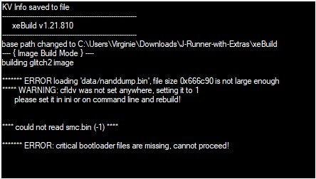

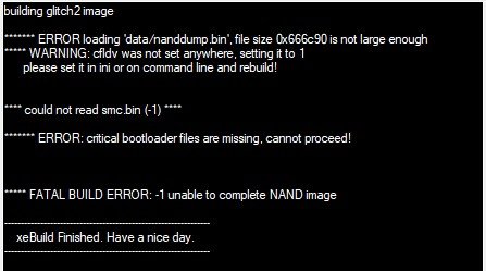

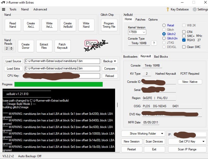

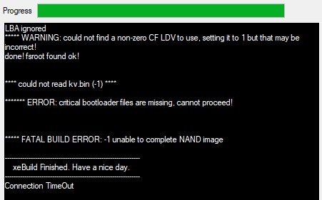

gerald56 1 Posted February 27 hi. i have a problem. When i click on "Create xeBuild" i have a lot of: "WARNING: nanddump.bin has a bad LBA at blocx 0x...." I can't find the problem ! Please can you tell me what's the problem ? thanks Quote Share this post Link to post Share on other sites
gerald56 1 Posted February 27 ok, i did the stuff with my origin nand ans it's better, but still have a problem Quote Share this post Link to post Share on other sites
Octal450 95 Posted February 27 My friend, your dumps are corrupted. Common Pico issue. Usually bad soldering or it failed halfway thru. Kind Regards, Josh Quote Share this post Link to post Share on other sites
gerald56 1 Posted February 28 Thanks Josh for you quick answer. i did back my soldering i get my first dump, and everythings all right, it's work. Thanks for the very impresive work. Kind regards, G 1 Quote Share this post Link to post Share on other sites
