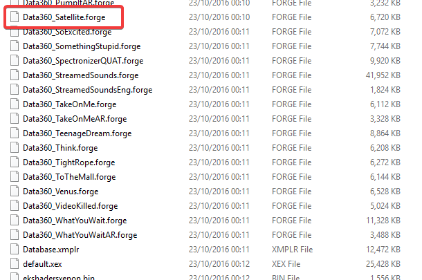

I have a Just Dance 3 Region Free version in my HD and I wanted to play "Lena - Satellite" in Just Dance 3, which is a song that exists only in the PAL version of the game.
I was checking the game's files and found out that the music file is there (check attached image 1), but it doesn't appear in the song list inside the game.

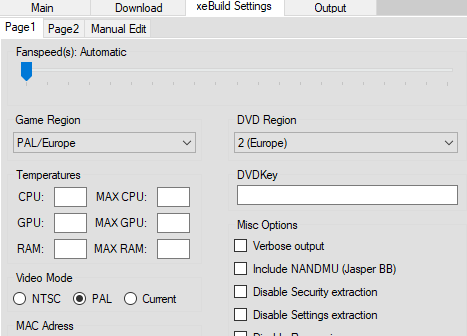

I already tried modifying the NAND with XeBuild GUI to have the PAL (Europe) Game Region, DVD Region, and Video Mode (check attached image 2), but the music didn't appear in the list as well.

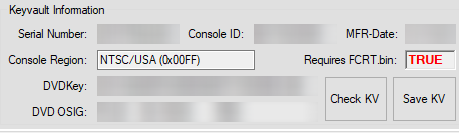

Regarding the NAND edition, I'm not even sure if I'm doing the change correctly. When opening the updated NAND with the xeBuild GUI it still shows "NTSC/USA" in the "Console Region".
Should this field change? Where can I see that the change was successful?
What I did was:
  1. Open my flashed dump
  2. Insert CPUKey
  3. Click "Switch to advanced mode" in the tools bar
  4. In the "Main" tab, under "Misc Options", check "Use Custom xeBuild Settings"
  5. In the "xeBuild Settings" tab, change "Game Region", "DVD Region", and "Video Mode" to PAL/Europe
  6. Click "Generate hacked image" button
  7. In the XBOX, use Simple NAND Flasher to write the new NAND file
Do I need to do something else?
