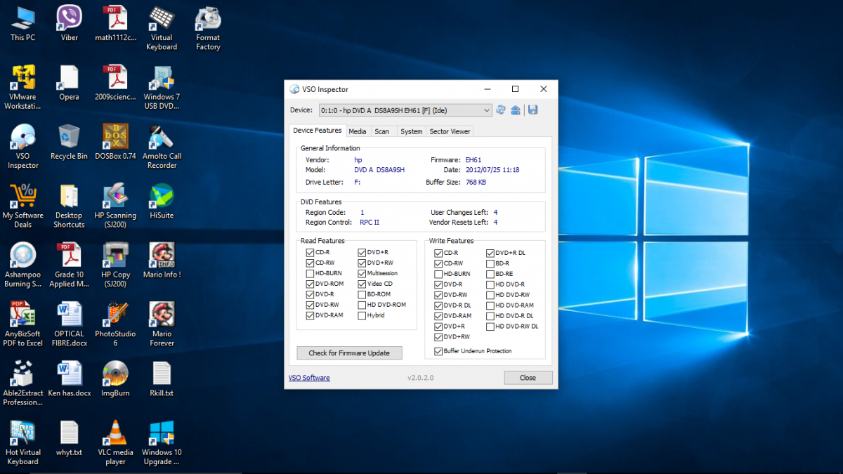

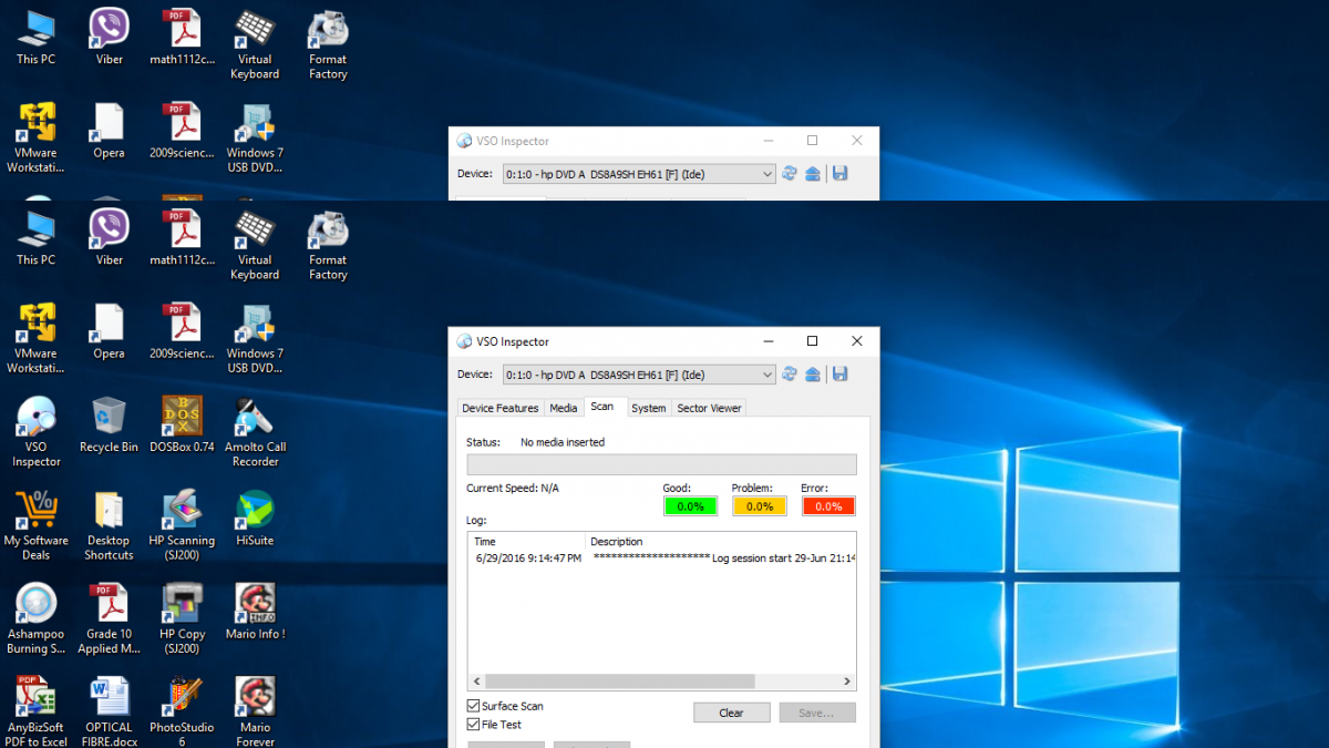

Shuraim Ahmet 29 Posted June 29, 2016 If its a faulty Media, there some programs out in the wild, you can check the quality of your burned DVDs. In most cases you can see its a bad media, or your Laser is worn. Hey mate that's what VSO shows me upon inserting DVD-RW disc. Share this post Link to post Share on other sites
Swizzy 2091 Posted June 29, 2016 That means the laser isn't too happy... Honestly tho, Laptop burners tend to be sucky suzy and aren't really made for quality burns, they're just there to "work" and will more often then not stop working after a while... Share this post Link to post Share on other sites
