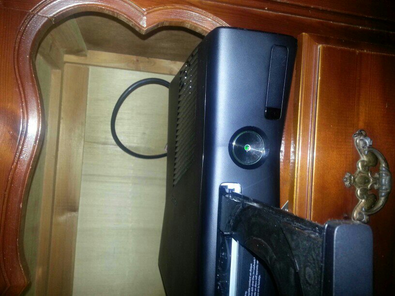

hamidmadrid 0 Posted February 8, 2014 Please help me I have trinity rgh xbox that won't start or boot, it stacked in the green light Sent from my GT-I9300 using Tapatalk Quote Share this post Link to post Share on other sites
JPizzle 0 Posted February 8, 2014 Need more info, did you just try to update or something??? Try to boot up with no HDD attached. Quote Share this post Link to post Share on other sites
hamidmadrid 0 Posted February 8, 2014 I didn't try to update, it was working normally yesterday and today it's not starting, I tried to boot without hdd and it didn't work (. Just stuck in the green light Sent from my GT-I9300 using Tapatalk Quote Share this post Link to post Share on other sites
Swizzy 2085 Posted February 8, 2014 What chip do you have? did you install it yourself? does the chip have a debug light? (does it blink anything inside your console?) Please provide as many details as you can Also, have you tried "power cycle" meaning, unplug the console from the PSU and TV, leave it like that for a few seconds then connect it all again... Quote Share this post Link to post Share on other sites
hamidmadrid 0 Posted February 8, 2014 I have trinity, but it was not me who did the rgh, there is a red light inside, I also tried the power cycle, didn't work, Sent from my GT-I9300 using Tapatalk Quote Share this post Link to post Share on other sites
Swizzy 2085 Posted February 8, 2014 Red light inside ussually means you've got a TX chip, Coolrunner Rev a, b, c or a CR3 Lite/Pro, DGX Converted to RGX or Slim Proto if you look inside you should see that there is a green light blinking every 5 seconds or so... if you see that it's trying to boot, if you don't then i'd recommend you going to whoever installed this for you and ask them to look into it as it's likely a faulty installation... (a cable isn't properly connected or so) Quote Share this post Link to post Share on other sites
hamidmadrid 0 Posted February 8, 2014 I will open it and see Yes there is a green light blinking What should I do now please? Sent from my GT-I9300 using Tapatalk Quote Share this post Link to post Share on other sites
Swizzy 2085 Posted February 8, 2014 Wait for it to stop blinking, if it takes > 5 minutes something's wrong somewhere and you'll probably need the help with using a hardware programmer to read/write the nand to see what's up, it could also be a chip issue (it not working correctly anymore) First thing's first, wait for ~ 5 minutes, if nothing happens... nothing is going to happen and you should etheir get hold of a NAND programmer or get someone help you dump it and check it... (probably easiest to go to the ppl that installed your chip in the first place) Quote Share this post Link to post Share on other sites
hamidmadrid 0 Posted February 9, 2014 YEAH I TELFT IT FOR 20 MIN AND NOTHING HAPPENED ( , ANYWAY I'LL TAKE TO THE PERSONE WHO GLITCHED IT ASND SEE . THANK YOU SO MUCH FOR YOUR HELP MATE ) Quote Share this post Link to post Share on other sites
