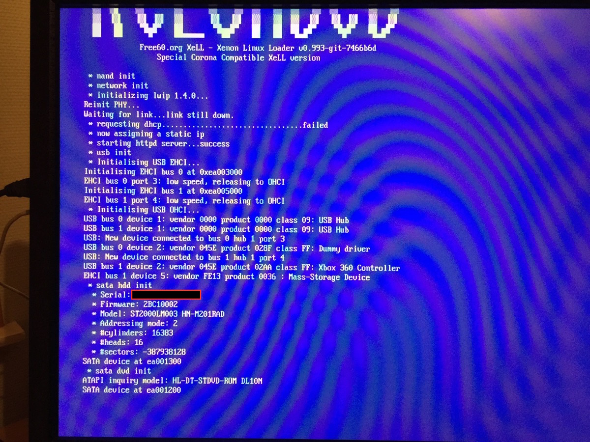

Thorz 27 Posted April 18, 2015 http://www.filedropper.com/xellreloaded-2stages-v0994tar <--- different site Hey Swizzy I am kind of stuck here. I have just updated software to 17150 using xeBuild_GUI_2.095 and I was thinking that Xell was going to be updated too when building the new NAND, but I still have v0.993 after the update. As you can see from this picture this version of Xell is presenting the known bug that makes it hang on SATA DVD discovery. Where can I download a newer version like the one you provided on your last post /the link is now dead)? Could you point me to an easy guide on how to install the newer Xell? Thank you. Quote Share this post Link to post Share on other sites
Swizzy 2091 Posted April 18, 2015 Hey Swizzy I am kind of stuck here. I have just updated software to 17150 using xeBuild_GUI_2.095 and I was thinking that Xell was going to be updated too when building the new NAND, but I still have v0.993 after the update. As you can see from this picture this version of Xell is presenting the known bug that makes it hang on SATA DVD discovery. Where can I download a newer version like the one you provided on your last post /the link is now dead)? Could you point me to an easy guide on how to install the newer Xell? Thank you. I didn't make it an official release, right now i don't really have it pre-compiled around either, there is a script i wrote that installs the toolchain for you, but you need to understand some linux basics before you'll be able to use it I might be able to setup a virtual machine again in a few days or so and compile it for you again, all of the code is available on the official XeLL github: https://github.com/Free60Project/xell or Libxenon github: https://github.com/Free60Project/libxenon if not in the main branch, there should be one with my name on it which has all of my testing code ** Edit: ** To make absolutely certain the DVD bug isn't going to bother you, you can disable the DVD functionality by uncommenting this line: https://github.com/Free60Project/xell/blob/Swizzy/source/lv2/config.h#L14 and compiling with the latest Libxenon toolchain ** Edit2: ** http://pastebin.com/QhMj9eXF <--- This is the install script i mentioned above^ Quote Share this post Link to post Share on other sites
