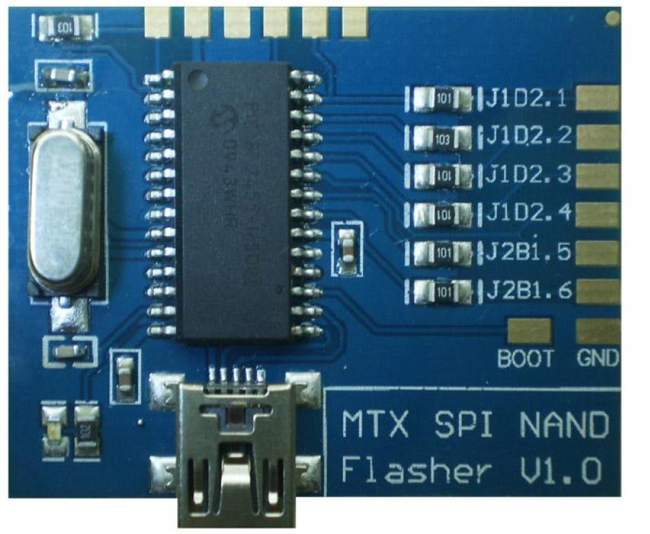

Sumaksanyi 1 Posted January 10, 2019 Alright, i ordered a nand programmer chip on "konzoluzlet.hu" (its a hungarian console shop if you're wonder whats that), and the sad thing is its out of stock, but i ordered one anyway, i can wait. The chip is a Matrix NAND Programmer MTX SPI Flasher V1.0. I looked up, and its compatible with every xbox 360 motherboard, so hope its gonna work with my motherboard. Quote Share this post Link to post Share on other sites
gavin_darkglider 1541 Posted January 12, 2019 That wont help you read a 4gb nand. Those are handled with SD card readers, and an adapter, or hard wires to a modified SD card reader. If you read what I said, you would have known you wanted a guide for a 4 gb corona. Now, if it turns out to be a bad nand, and you have the equipment and skill to do the nand conversion to 16mb nand image, then the device you bought will be useful. Quote Share this post Link to post Share on other sites
