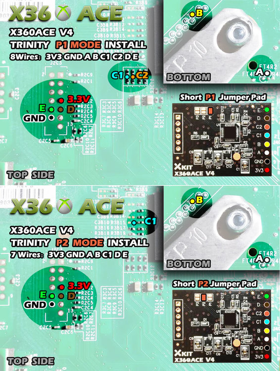

rover820 0 Posted March 17, 2019 just installed ace v5 on a trinity P1 install and it boots between 1-3 every time loving it Quote Share this post Link to post Share on other sites
BlueSn00w 21 Posted March 25, 2019 the ace v5 is usually shit on trinitys. Its OK on coronas. I recommend the matrix v3 with oscillator so you can do falcon - corona with it. Quote Share this post Link to post Share on other sites
rover820 0 Posted April 2, 2019 to be honest i have never had a problem with the ace chips and i have done 3 trinity on the ace 5 using the P1 method and have had great boot times so i suppose its all down to prefrence really Quote Share this post Link to post Share on other sites
goldmoon 0 Posted May 9, 2019 Hi, About the ace V5 on Trinity. NEWER USE P1 install for Trinity! Has killed two trinity MB. first power on glitch correctly but no Xell. after restart no glitch anymore. Write back the original nand I got ROD. but with P2 install Trinity boot until 5sec, always. Quote Share this post Link to post Share on other sites
ar4ijss 0 Posted October 20, 2019 On 5/10/2019 at 12:07 AM, goldmoon said: Hi, About the ace V5 on Trinity. NEWER USE P1 install for Trinity! Has killed two trinity MB. first power on glitch correctly but no Xell. after restart no glitch anymore. Write back the original nand I got ROD. but with P2 install Trinity boot until 5sec, always. Had the same issue but I messed c1 and c2 points(resistors from HANA). After some time, I was bored and tak'ed same board, bridged resistors and board started to work! Sorry for bad english, I'm from Mars. Quote Share this post Link to post Share on other sites
Decrypt786 4 Posted January 12, 2020 How did you do the bridge? You brided across c1 to c2 or from c1 resistor 1 to c1 resistor 2 and the same for c2? Quote Share this post Link to post Share on other sites
