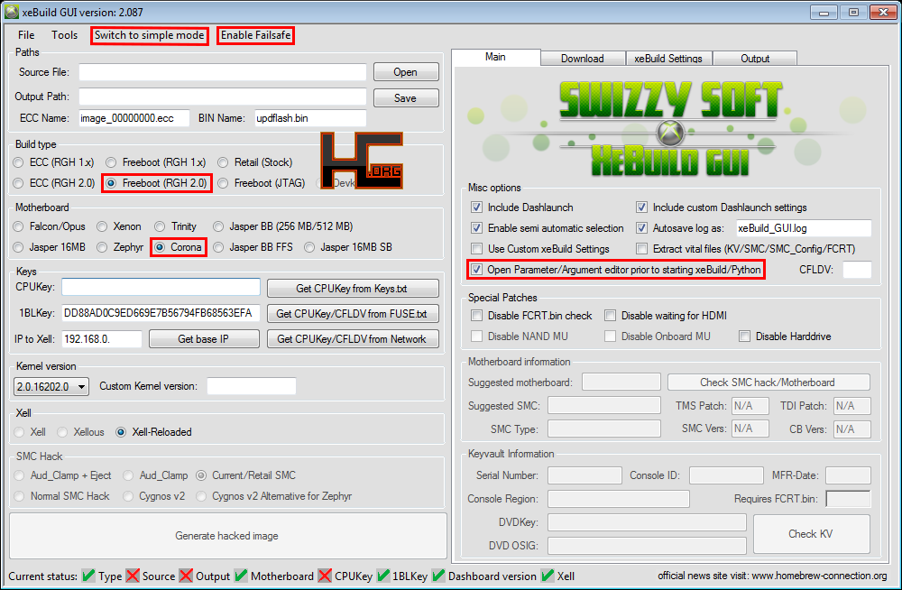

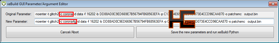

Theanat 0 Posted June 18, 2015 At first my all xbox USB ports works properly But after I update the version Dashboard to 17349 ( I used Xebuil v2.094 & follow the tutorial from these picture ) all the usb ports not detect to xbox . . I have format to Fat32 but still won't work . Could anybody help me please . T.T Quote Share this post Link to post Share on other sites
felida 1653 Posted June 19, 2015 At first my all xbox USB ports works properly But after I update the version Dashboard to 17349 ( I used Xebuil v2.094 & follow the tutorial from these picture ) all the usb ports not detect to xbox . . I have format to Fat32 but still won't work . Could anybody help me please . T.T did you try downgrading and see if they work?? and i believe you should have used this version to update to 17349.. (xebuild gui 2.096.. not 2.094) http://www.realmodscene.com/index.php?/topic/5391-xebuild-115-xebuild-gui-2096-17349-kernel-support-added/ 2 Quote Share this post Link to post Share on other sites

Swizzy 2085 Posted June 19, 2015 did you try downgrading and see if they work?? and i believe you should have used this version to update to 17349.. (xebuild gui 2.096.. not 2.094) http://www.realmodscene.com/index.php?/topic/5391-xebuild-115-xebuild-gui-2096-17349-kernel-support-added/ On top of that, i don't offer any support for unofficial versions (2.094 with the files for 17349 is unofficial, unless of course you manually downloaded xeBuild and added those files to it... in which case, it's still technically unofficial) 2 Quote Share this post Link to post Share on other sites
felida 1653 Posted June 19, 2015 On top of that, i don't offer any support for unofficial versions (2.094 with the files for 17349 is unofficial, unless of course you manually downloaded xeBuild and added those files to it... in which case, it's still technically unofficial) that's why i pointed him to the release thread 2 Quote Share this post Link to post Share on other sites
