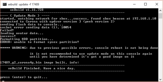

cozmo72 9 Posted October 5, 2015 Hi guys, any idea what went wrong? also xbox wont turn on now, which tutorial do i need to follow to fix it? Cheers guys Quote Share this post Link to post Share on other sites

cozmo72 9 Posted October 7, 2015 Ok, so I got my nand and got the updflash.bin using the latest XeBuild and following the tutorial. As i cant load up my dashboard and can only load xell I put the updflash.bin on an empty usb stick and tried to update through xell. It recognised that the usb was mounted but nothing else happened. Then I tried rawflash v4 putting the xenon.elf file in the root with the updflash.bin and started that up. All it loads to though is a black screen. Any ideas what else i can do? Thanks again Quote Share this post Link to post Share on other sites
Swizzy 2091 Posted October 7, 2015 What size is the dump? 16 or 48 MB? if it's 48 you need hardware to flash your NAND (MMC reader) Quote Share this post Link to post Share on other sites
cozmo72 9 Posted October 7, 2015 Yes its 48. Are there any tutorials around to help with that? Thanks Quote Share this post Link to post Share on other sites

BestNoob 75 Posted October 16, 2015 OMG ! I have the same Problem -.- I always used J-Runner for Updating my Box and this was the first time i used xeBuild_GUI. Maybe that was the mistake. And now after succesfully flahing via xell my xbox is dead. Red light inside my box is all time on and the green light is blinking blinking blinking lighting and that again and again. i cannot go into xell or smth else. Its a 360 E console. Quote Share this post Link to post Share on other sites
Swizzy 2091 Posted October 16, 2015 OMG ! I have the same Problem -.- I always used J-Runner for Updating my Box and this was the first time i used xeBuild_GUI. Maybe that was the mistake. And now after succesfully flahing via xell my xbox is dead. Red light inside my box is all time on and the green light is blinking blinking blinking lighting and that again and again. i cannot go into xell or smth else. What chip do you have installed in your console? The only differences that i know of between JRunner and xeBuild is that JRunner have the CR4 and R-JTAG SMC's which aren't part of xeBuild GUI... the CR4 SMC should be kept despite tho... the only one that would be replaced is R-JTAG Quote Share this post Link to post Share on other sites
BestNoob 75 Posted October 16, 2015 What chip do you have installed in your console? The only differences that i know of between JRunner and xeBuild is that JRunner have the CR4 and R-JTAG SMC's which aren't part of xeBuild GUI... the CR4 SMC should be kept despite tho... the only one that would be replaced is R-JTAG I dont know i bought this console a half year before in a shop. The only thing i can see is that the Chip has a green and than a red led at the left side. at the small side of the chip. Quote Share this post Link to post Share on other sites
Swizzy 2091 Posted October 16, 2015 It's a TeamXecuter chip most likely... the green led you mention, is that the chip or the center led on the console? Basically, if it's the chip that's blinking green the console is trying to boot up again, but it's not working for some reason... i doubt it has anything to do with xeBuild GUI over JRunner... it's more likely a random error that would've happened with either, unless of course your particular console had 13182 CB_B? (this would indicate your console have Winbond 2K RAM which requires a slightly different patchset from other corona consoles) Can you send me your NANDDump so i can check if that's the case? Quote Share this post Link to post Share on other sites
BestNoob 75 Posted October 16, 2015 It's a TeamXecuter chip most likely... the green led you mention, is that the chip or the center led on the console? Basically, if it's the chip that's blinking green the console is trying to boot up again, but it's not working for some reason... i doubt it has anything to do with xeBuild GUI over JRunner... it's more likely a random error that would've happened with either, unless of course your particular console had 13182 CB_B? (this would indicate your console have Winbond 2K RAM which requires a slightly different patchset from other corona consoles) Can you send me your NANDDump so i can check if that's the case? I mean the green light on the chip. Its a 16MB NAND. Ye but isnt it ironic i never used xeBuild before and the first tiem i use it ..... this happens ... Quote Share this post Link to post Share on other sites
