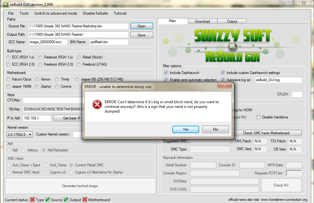

Read the tutorial in my signature below, it explains how to handle 4GB Corona consoles, that's what you have if your dump is 48MB, otherwise it's a bad dump which you need to do again with a different USB memory or something with more space on it...
Yes the NAND size is 48Mb. Will follow your tutorial for Corona 4Gb and try updating the console tomorrow . Thank you very much for the help Swizzy =)

Hello. I am a new learner to modding . I got a 360 slim with dashboard 16537 and it has been rgh'ed . I was trying to update my Kernel to 17489 as I was unable to play few games which required a newer Kernel version than 16537.
I tried dumping my nand through Simple 360 but whenever I try opening the flashdump on XEbuild I am getting an error stating Can't determine if it is a big or small block NAND.
I am quite sure I followed the previous steps correctly but don't know why this error shows. I am attaching a screenshot so you guys can have a better understanding of my problem. Please help me out of this as I am stuck and don't know how to proceed now.
Any help would be deeply appreciated. Thank you =)
