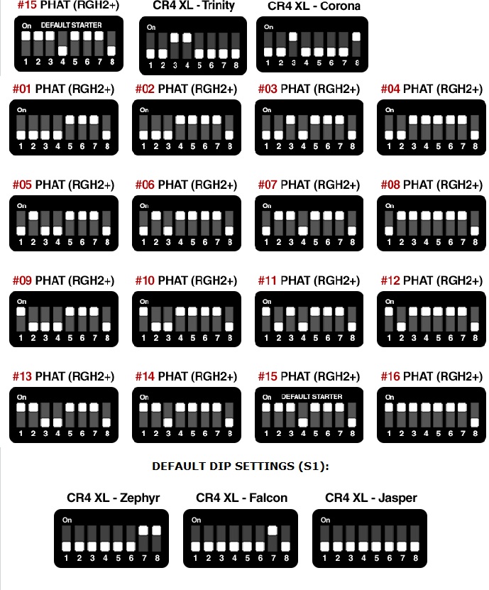

More than likely it's a broken solder point or cold joint due to heat if the original modder didn't create a decent cooling profile for it in dashlaunch...
The maximum price to fix it is relative to what wrong with the console. You'd have to open it and provide some pictures if you wanted a better idea on what is or at least what isn't wrong with it.
Pictures of all the wiring would do wonders as well as letting us know which model of Xbox 360 it is.
Use this to figure out what model you have and then when you get it open, take a picture of the modchip so you know which one was used, then I could probably get you a wiring pinout which would let you be able to visually check the problem yourself..
Not sure if you've seen these or not before on the TX forum/howto wiki, but I compiled them for personal use since I find that default DIP settings on heat damage used consoles that I refurbish // hack almost always need a custom DIP setting.
As for the jumper, I find that having it in the middle is usually the most sucessful and I like to also solder in a 30uf disc cap.
