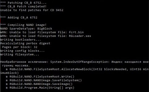

Hi guys!
Got this error "System.OutOfRangeException"
1. I turned off my antivirus
2. Tried different versions of Kernel
And this happens again and again.
Help please, how can I solve this problem?

Rgloader is only for 16mb nands.. you have a big block jasper..
It will not work..

Try this build does work with bb jaspers and includes xell
Only rgh2 has been tested. Rgh1 should work but not jtag.
