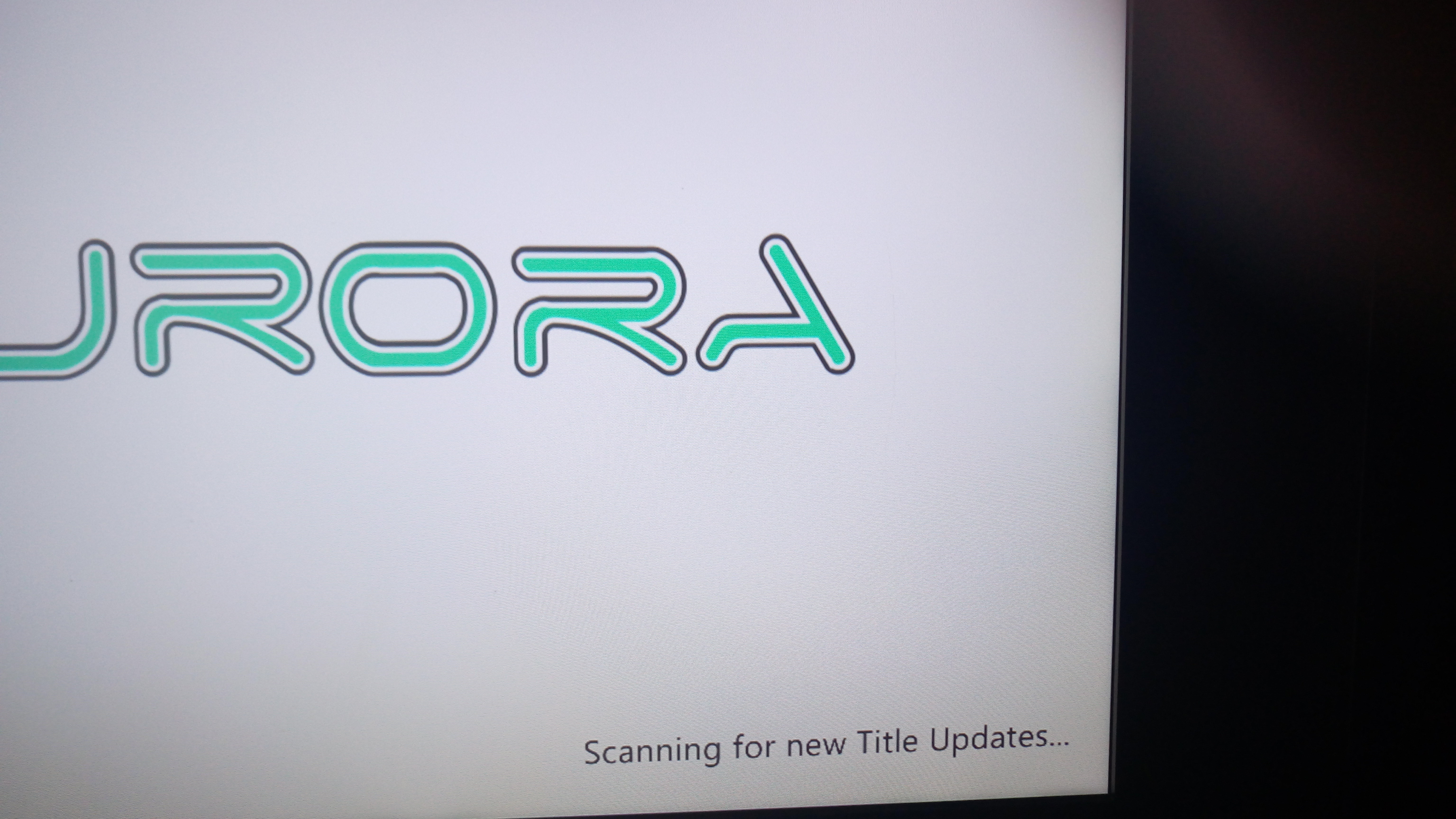

MasterWarrior17 0 Posted February 9, 2019 Hey guys! So yesterday I was trying to set up Xbox Neighborhood. Used Dash Launch to select the xbdm plug in and decided to reboot the console, but after reboot it seems Aurora is stuck at scanning new title updates screen. I left it overnight hoping that would fix it but it didn't Is it a problem or is it normal? What else can I do? Quote Share this post Link to post Share on other sites
Neocazen 28 Posted February 9, 2019 29 minutes ago, MasterWarrior17 said: Hey guys! So yesterday I was trying to set up Xbox Neighborhood. Used Dash Launch to select the xbdm plug in and decided to reboot the console, but after reboot it seems Aurora is stuck at scanning new title updates screen. I left it overnight hoping that would fix it but it didn't Is it a problem or is it normal? What else can I do? To boot using a pendrive with Aurora and undo Dashlaunch settings 1 Quote Share this post Link to post Share on other sites
MasterWarrior17 0 Posted February 9, 2019 How do I boot from a USB? Will it launch automatically? Quote Share this post Link to post Share on other sites
MasterWarrior17 0 Posted February 9, 2019 24 minutes ago, Neocazen said: To boot using a pendrive with Aurora and undo Dashlaunch settings 24 minutes ago, Neocazen said: To boot using a pendrive with Aurora and undo Dashlaunch settings How do I boot from USB? Will it launch automatically? Quote Share this post Link to post Share on other sites
felida 1658 Posted February 9, 2019 8 hours ago, MasterWarrior17 said: How do I boot from USB? Will it launch automatically? You put a launch.ini on the USB drive.. Without xbdm.xex set in plugin.. But.. Xbdm.xex wouldnt mess with aurora.. If you used the wrong version of xbdm your xbox would e-78.. What other plugins are you using?? Quote Share this post Link to post Share on other sites
MasterWarrior17 0 Posted February 9, 2019 1 hour ago, felida said: You put a launch.ini on the USB drive.. Without xbdm.xex set in plugin.. But.. Xbdm.xex wouldnt mess with aurora.. If you used the wrong version of xbdm your xbox would e-78.. What other plugins are you using?? I don't think it's the xbdm too. I use a GTA V mod menu and I downloaded the xbdm plugin from Modded Warfare's video. Also will putting a launch.ini file on a USB work? Wouldn't Dash Launch choose the one on my HDD? Quote Share this post Link to post Share on other sites
felida 1658 Posted February 9, 2019 11 minutes ago, MasterWarrior17 said: I don't think it's the xbdm too. I use a GTA V mod menu and I downloaded the xbdm plugin from Modded Warfare's video. Also will putting a launch.ini file on a USB work? Wouldn't Dash Launch choose the one on my HDD? No.. It goes by USB first.. Then hdd.. Its done that way so stuff like this can be fixed.. And it is your mod menu.. Lmao.. 99% of the time.. Thats the problem Quote Share this post Link to post Share on other sites
MasterWarrior17 0 Posted February 9, 2019 35 minutes ago, felida said: No.. It goes by USB first.. Then hdd.. Its done that way so stuff like this can be fixed.. And it is your mod menu.. Lmao.. 99% of the time.. Thats the problem Weird. I've been using the mod menu for an year now and it worked flawless. I will try the USB method now. Thx Quote Share this post Link to post Share on other sites
MasterWarrior17 0 Posted February 9, 2019 57 minutes ago, felida said: No.. It goes by USB first.. Then hdd.. Its done that way so stuff like this can be fixed.. And it is your mod menu.. Lmao.. 99% of the time.. Thats the problem Tried it just now. It didn't work maybe I am doing smth wrong. Will it work If I connect my 360 HDD to my PC and remove Aurora as my default in main launch.ini? EDIT: Hmm the Xbox guide button seems to be working, I am able to use the file browser from there, tried launching Freestyle but the console freezes when I select it Quote Share this post Link to post Share on other sites
felida 1658 Posted February 9, 2019 48 minutes ago, MasterWarrior17 said: Tried it just now. It didn't work maybe I am doing smth wrong. Will it work If I connect my 360 HDD to my PC and remove Aurora as my default in main launch.ini? EDIT: Hmm the Xbox guide button seems to be working, I am able to use the file browser from there, tried launching Freestyle but the console freezes when I select it you need to put a default launch.ini.. one where it has no plugins Quote Share this post Link to post Share on other sites
MasterWarrior17 0 Posted February 9, 2019 1 minute ago, felida said: you need to put a default launch.ini.. one where it has no plugins I am going to download one from online Quote Share this post Link to post Share on other sites
MasterWarrior17 0 Posted February 9, 2019 On 2/9/2019 at 7:52 PM, felida said: you need to put a default launch.ini.. one where it has no plugins I downloaded this one: https://www.realmodscene.com/index.php?/topic/4938-launchini/ Transferred to my USB, connected it to my Xbox and booted it up, but still the same thing. Quote Share this post Link to post Share on other sites
gavin_darkglider 1563 Posted February 10, 2019 Try a fresh copy of aurora. If the title update scan fails, it could be because of a corrupt titleupdate, or because of a corrupt dlc. If it works, and scans them all fine, chances are there is something a miss in the database. 1 Quote Share this post Link to post Share on other sites
MasterWarrior17 0 Posted February 11, 2019 12 hours ago, gavin_darkglider said: Try a fresh copy of aurora. If the title update scan fails, it could be because of a corrupt titleupdate, or because of a corrupt dlc. If it works, and scans them all fine, chances are there is something a miss in the database. Hey! I was able to solve the problem yesterday by connecting my Xbox 360 HDD to my PC via SATA cable, opening up Xplorer360, and editing my main launch.ini (removed launch defaults and plugins). Thanks for replying Quote Share this post Link to post Share on other sites
