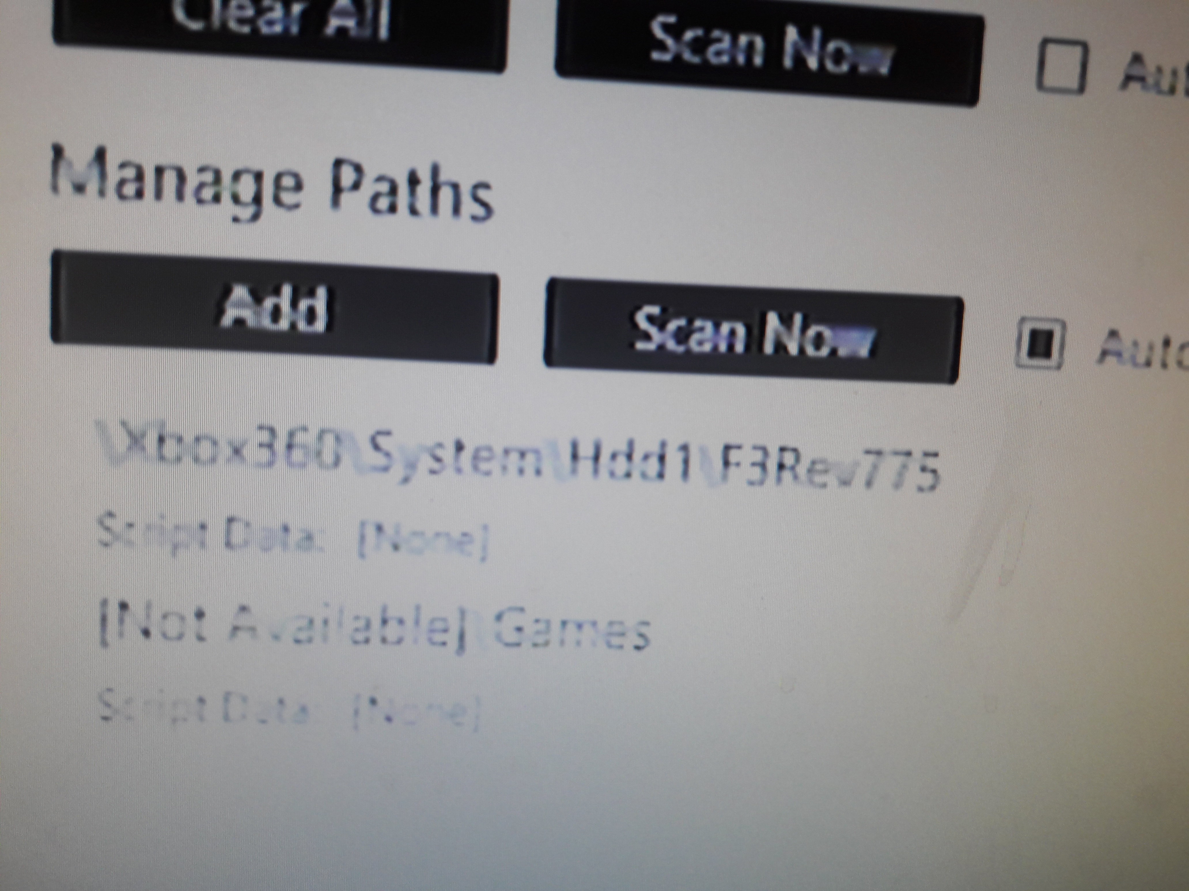

danial1380 2 Posted August 25, 2018 The cover of the games changes to black color and the founder of the founder can not be seen After the restoration of the Aurora, it appears Quote Share this post Link to post Share on other sites
danial1380 2 Posted August 25, 2018 Video of my problem: help me WIN_13970603_23_57_20_Pro.mp4 Don`t post your questions/problems multiple times in the forum ! Dr.Gonzo. Quote Share this post Link to post Share on other sites

mightyhama 2 Posted August 26, 2018 I don't think you followed advice that's been offered. On your external drive rename your GAME folder to Games or games, both options work for me. Then re-set you game scan path's in Aurora n you should be fine.Hope this help's Quote Share this post Link to post Share on other sites
danial1380 2 Posted August 26, 2018 Friends thank you for helping me, but my problem did not fix. I have my own game folder named: GAME GAMES game 360game 360games games I've changed but I do not have access to an Auror. In FreeStyle, this is not a problem for me There is only problem in Aurora Quote Share this post Link to post Share on other sites
Swizzy 2083 Posted September 23, 2018 On 8/26/2018 at 12:18 PM, danial1380 said: Friends thank you for helping me, but my problem did not fix. I have my own game folder named: GAME GAMES game 360game 360games games I've changed but I do not have access to an Auror. In FreeStyle, this is not a problem for me There is only problem in Aurora The issue is most likely with the cabinet or whatever you have to connect the SSD to your console Cheap cabinets take shortcuts and don't have a real serial sent to the console. Aurora tracks devices by their serial, if it doesn't get the same serial twice from the HDD/SSD it'll fail to detect it as the same device The issue is unlikely to be related to "Game" or "Games", it's likely to be related to the cabinet/enclosure used, get another one and it'll probably work... but it could also be the use of a SSD vs. a HDD, a SSD run WAY faster than a HDD does, and the Xbox 360 doesn't really work that well with SSD's Quote Share this post Link to post Share on other sites
