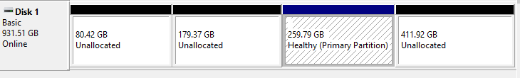

dogmaticas 5 Posted October 10, 2016 Hi Guys, I have 2 USB HDD connected to my Xbox 360 and until i was using FSD i could disconnect them from Xbox, connect to Windows PC add some games in them, connect back to Xbox. Everything was fine. This weekend i decided to move to Aurora. Everything was fine, i really enjoyed how Aurora is working. Today i decided to add some new games and plugged one of the drives in to Windows PC, but PC cant recognize my USB HDD anymore. I tried another one and i have same situation. I have attached prtscr from windows disk manager. So, my question is, could change from FSD to Aurora cause this situation? Is there a way to fix my external HDD, so it could be recognizable on Windows again? Interesting, that one of the drives has 700GB of free space, another 160GB, but Windows disk manager shows same view for both of the drives 4 Quote Share this post Link to post Share on other sites

Swizzy 2080 Posted October 11, 2016 It's definietly a bad hdd or something, neither Aurora nor FSD directly access the hdd, all of that is done by the 360 Kernel... and, that looks really messed up as it should show 2 blocks of unallocated, not 3 like that... but... should even be a single one normally... Sent from my SM-G903F Quote Share this post Link to post Share on other sites

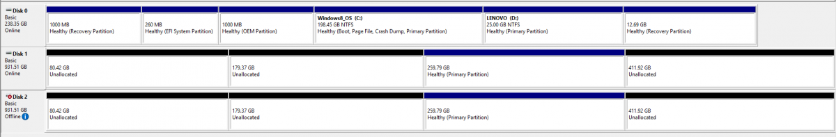

Swizzy 2080 Posted October 11, 2016 Are you sure the drive in your screenshot is the external hdd and not something else attached to your pc? Can you take a screenshot showing all drives in that view? Sent from my SM-G903F Quote Share this post Link to post Share on other sites
dogmaticas 5 Posted October 11, 2016 Yes, i'm positive about this please see attached prtscr. Disk 0 - it's PC HDD Disk 1 and Disk 2 - these are Xbox external drives. Quote Share this post Link to post Share on other sites

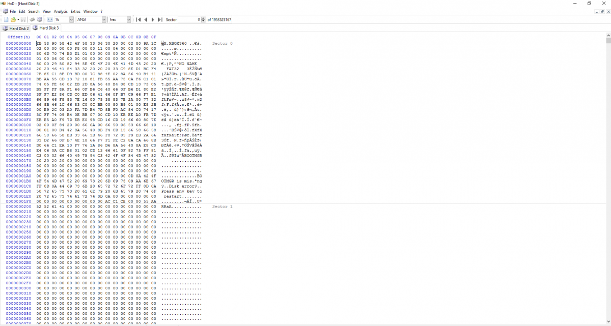

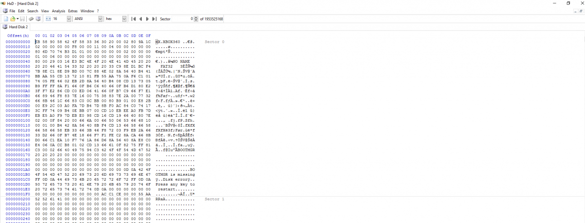

dogmaticas 5 Posted October 11, 2016 Please see attached 0 sector view for both disks. If you need to view more sectors please let me know which of them you need. Quote Share this post Link to post Share on other sites
