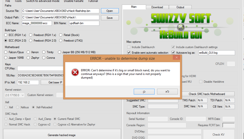

ACe8 1 Posted May 13, 2015 well.. i tried to rebuild my nand becouse swizzy's advice was gread but still there was a problem with the nand.. the xeBuild is giving me this.. Quote Share this post Link to post Share on other sites
Swizzy 2079 Posted May 13, 2015 well.. i tried to rebuild my nand becouse swizzy's advice was gread but still there was a problem with the nand.. the xeBuild is giving me this.. xeBuild error.png read this: http://xebuildtut.xeupd.com/ Quote Share this post Link to post Share on other sites

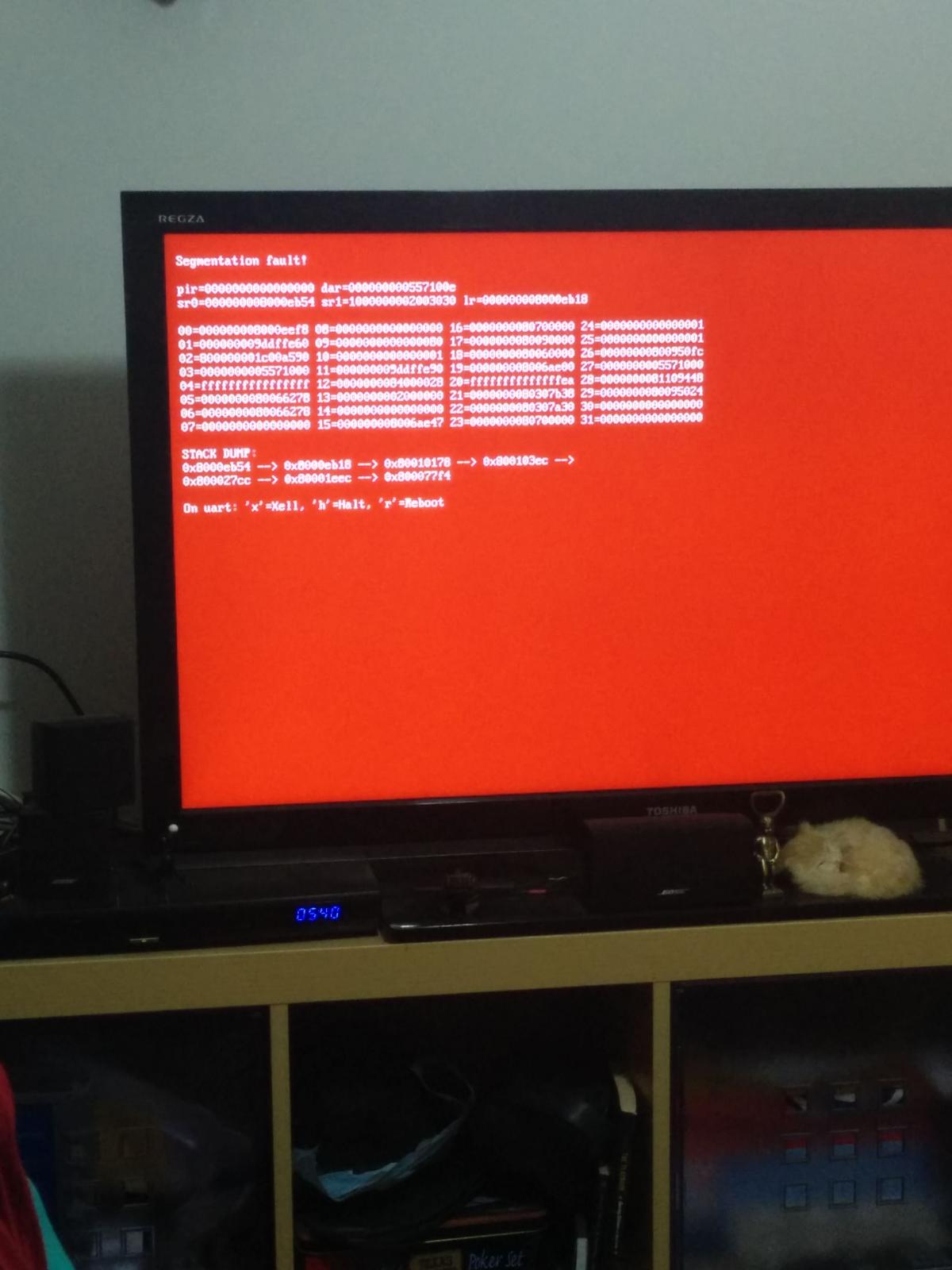

Remmigiosh 17 Posted January 18, 2017 On 5/13/2015 at 0:39 PM, Swizzy said: read this: http://xebuildtut.xeupd.com/ Hi Swizzy / or anyone else willing to help By accident I started my box by pressing the eject button, and got greeted with this red screen: Does anyone know how to read these numbers or tell me what's wrong? Bad flash? I've been using the same setup since I flashed when 17502 came out. Is a "segmentation fault" a fault in a part of the nand? The ones with all the F's at adress 08 and 28? My xbox sometimes takes a long time to boot (like couple hours) with the normal on/off button. It always bothers me, but I got used to it I guess... Info: Xbox 360 Slim with a Corona board, RGH2, Dash 17502, Dashlaunch/FSD/Aurora. I used XeBuild GUI 2.098 to build the 17502 nand... And is that link xebuildtut.xeupd.com available somewhere else? It's offline from my seat I was wondering if it would help me. Thanks in advance for any advice! Quote Share this post Link to post Share on other sites
Swizzy 2079 Posted January 18, 2017 It means XeLL Crashed, you need to have the full elf made during the compilation to tell exactly where it crashed and why... Most of these are caused by USB memory sticks etc. so try removing those, try removing anything you don't need... http://forum.homebrew-connection.org/index.php?topic=144.0 <--- you can find it here Quote Share this post Link to post Share on other sites
Remmigiosh 17 Posted January 18, 2017 1 hour ago, Swizzy said: It means XeLL Crashed, you need to have the full elf made during the compilation to tell exactly where it crashed and why... Most of these are caused by USB memory sticks etc. so try removing those, try removing anything you don't need... http://forum.homebrew-connection.org/index.php?topic=144.0 <--- you can find it here Thank you! I do have a USB HDD connected. Duh sorry for my ignorance. And thanks for the link! Now i hope I can figure out how to shorten my boot-time with the right options/settings when I build a new nand (with the latest dash 17511). Quote Share this post Link to post Share on other sites
