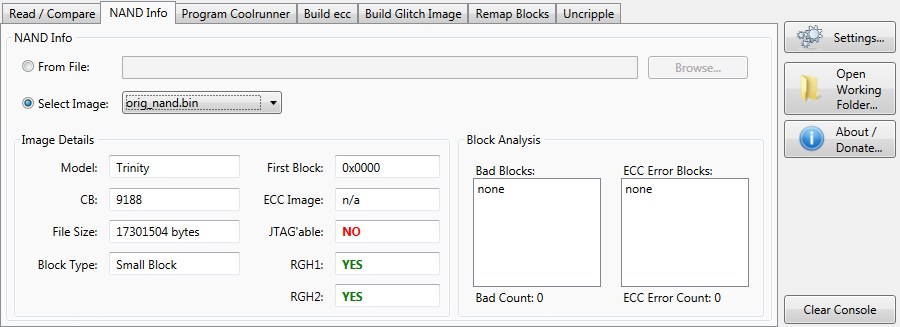

jigbim 3 Posted November 23, 2012 when you say "original image" do you mean the one you read from console or the actual original image (if you were given a copy when you got the console) the original will be retail not rgh load the image you read from console into XNandHealer and post result also do same with image created Quote Share this post Link to post Share on other sites

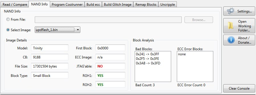

mko 0 Posted November 23, 2012 With "original image" I mean the one I read from the console. I don't have the "original original". Here is the output from XNandHealer. I hope that is the info you were looking for. The "original" before I tried to update: And the new image: Thank you SO MUCH for trying to help . Quote Share this post Link to post Share on other sites

jigbim 3 Posted November 23, 2012 Exactly as above no bad blocks in read so none should appear in created image Quote Share this post Link to post Share on other sites

mko 0 Posted November 23, 2012 Thanks guys, you're all the best for trying to help me. whatever you used to create the image has created a bad one, use XeBuildI'm not so sure about that. I tried using XeBuildGUI and jrunner. And NAND Flasher 360 definitely showed a few bad blocks when dumping the image, I don't know why they don't show up in the "before-image". But I'll try some things. Exactly as above no bad blocks in read so none should appear in created image It's weird, there should be bad blocks in the bad read. I saw it in the NAND Flasher 360 output. Maybe it immediately remapped them somehow?I got this before, I removed hard drive, powered xbox and it booted, powered off, plugged back in the HD and powered the xbox and it was fine.Thanks. I have removed the hard drive, but it still doesn't work. Sadly I can't remove the internal 4GB memory to try that .Thanks guys. Keep them coming. If nothing works I'll have to find someone who can physically flash the NAND and hope that helps. Quote Share this post Link to post Share on other sites
