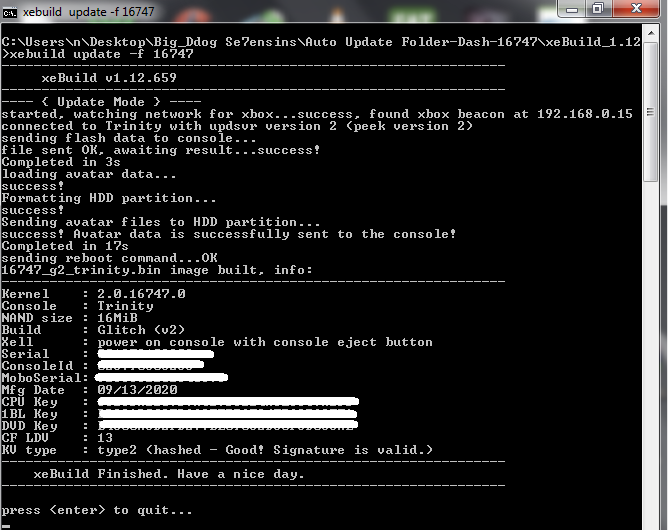

Formatting HDD partition in the log when updating avatar and kinect data?
Say what?
Sent from my SM-G903F
Here it says.
Yeah, there's a partition for the Avatar data which is formatted prior to putting the new files on it, that happens always with both xebuild and when doing a normal install (from USB)
An hidden partition then, understood. Worried for my not hidden normal internal HDD partition where i have all my things except games...
Nothing to worry about :) it's perfectly safe to do ^^
