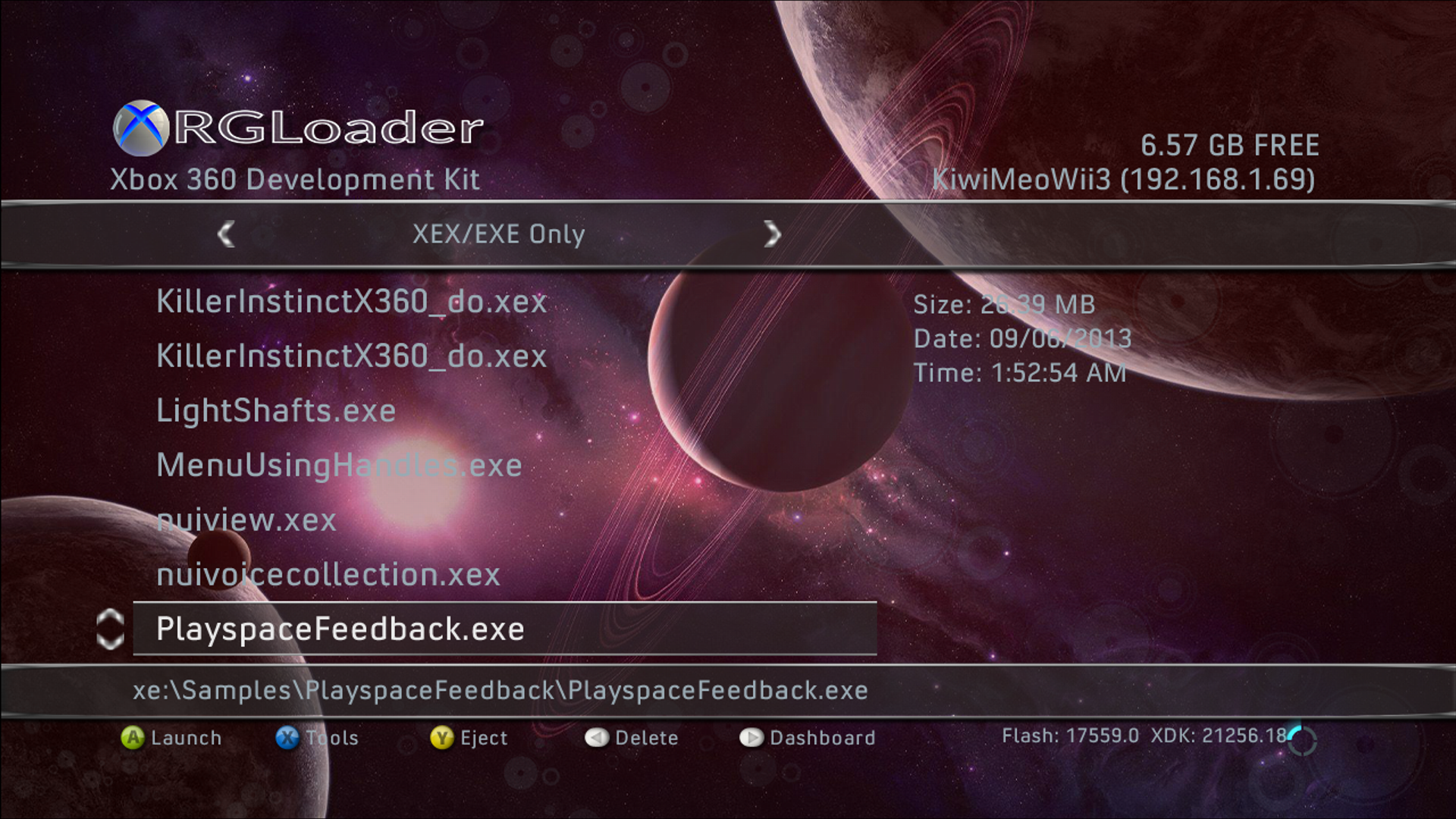

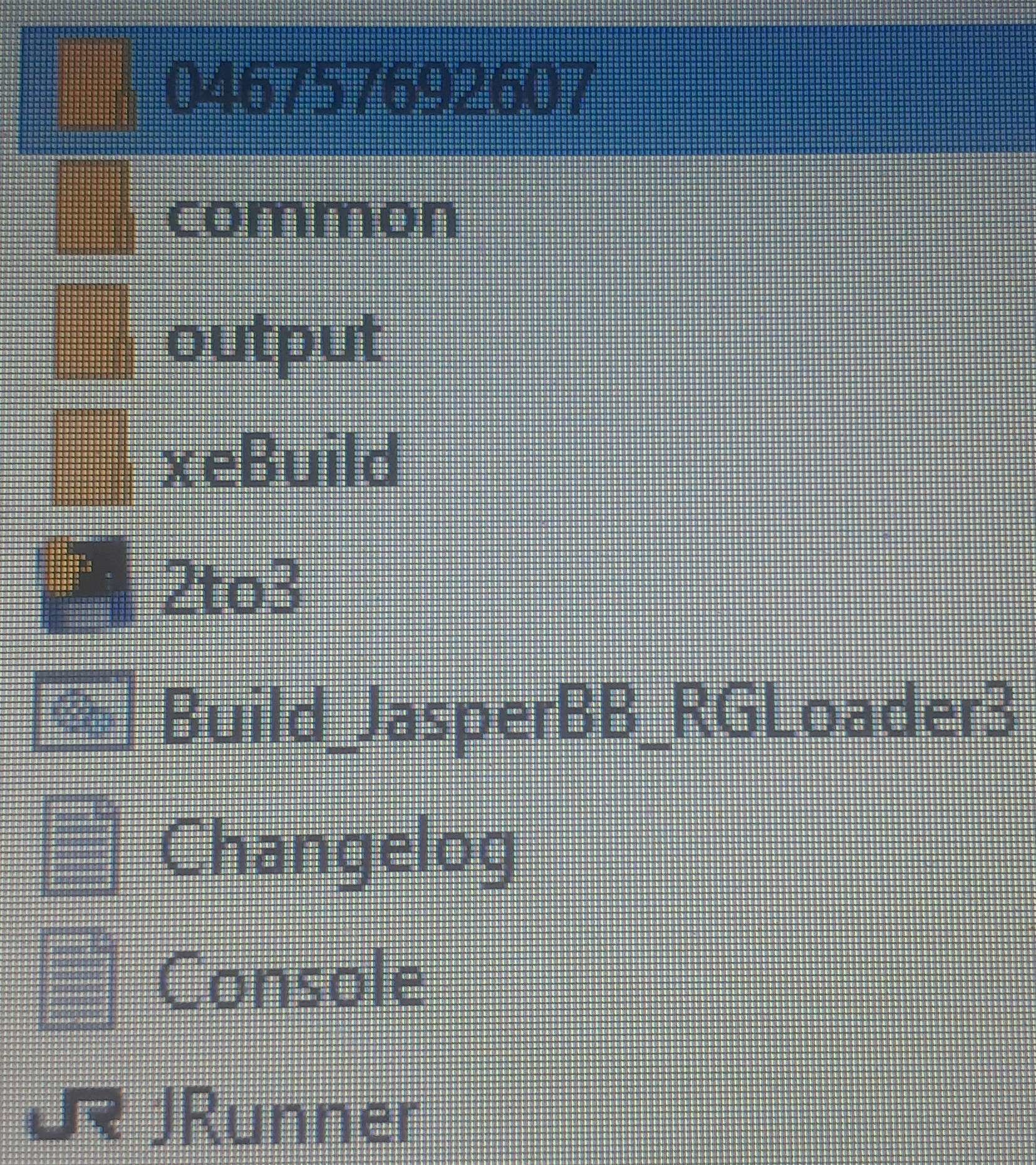

KiwiMeoWii 52 Posted June 10, 2023 Still in beta stages. Only tested on rgh3 Jasper big block. PLEASE USE AT YOU'RE OWN RISK Big shout out to Pro-Moddz appreciate you for letting me test for you all these years brother. especially for rgh2 bb rgloader. Was awesome. Then now this rgh3 rgl build🙏 will need Octal450 latest J-Runner-with-Extras. Make a copy of it. I would assume you're bb jasper is already rgh3!! & be on the latest kernel update 17559 & have the avatar update etc. (Ensure this is done prior before flashing over the rgloader nand. If you want avatars working) You will need to have your cpukey.text & to extract your rgh3 bb nand via jrunner. (Google how to) EXAMPLE: Extracts-04757692607. Remove the Extracts- keep the console ID number. Inside this rename the KV_dec.bin & SMC_dec.bin to just KV.bin & SMC.bin. copy your cpukey.text here also. Copy the 04757692607 folder to the root of Octal450 J-Runner-with-Extras. Assuming you have the RGLoaderJasperBB(RGH3) download. Copy N Paste the J-Runner-with-Extras build from within it over Octal450 J-Runner-with-Extras (Let it Overwrite everything) Example: should look like this. Now hit the Build-JasperBB-RGLoader3.bat file Enter Console Serial: Example 046757692607 then hit enter to start building your nand first build will build an rgloader2.bin file, press enter to carry on with build process, will covert that rgh2 nand into the 1st RGLoader3.bin & build another RGLoader3_10mhz.bin once program has finished & closed. There will be x2 nands (inside your extracted nand folder) both nands have been tested. flash via jrunner & programmer or Rename one to updflash.bin & flash via xell or simple 360 nand flasher via console. Features. 1. Xshell + Retail (with or without the hdd) 2. Xshell spoofed to 17559, Retail 17489 (without hdd) with (hdd Retail also spoofed to 17559) 3.Launch Xshell in the Hud (replaces family settings) (works with or without hdd) 4. rgloader.ini on your FLASH. (Run plugins at your own risk) (enables Launch Xshell in hud. why the rgloader.ini is built into the nand) 5. Connect via wifi or directly to router. (Will connect to internet. Live connection will be blocked) 6. Avatars should work (if you done what I stated above) or place the 17559 $SystemUpdate folder on Root of HDD. Will apply avatar update if not applied already 7. can run another rgloader.ini from root of hdd. Run plugins from this. I wouldn't use the one in flash but It can be used. (You were warned) 8. Disc drive: plays retail discs. 9. Xell via eject 10. Full xdk-rgl build. Flash filesystem will show via nieghborhood Basically has all the rgloader features. In the NAND. Also comes with my 3 themes I made for rgloader plus the original rgloader theme & xna with original xshell blue background theme. (Build into nand) if you not feeling my theme. As the build adds my rgloader theme into it. First picture in post. New Link added. Removed all the useless files from build. I should of done this before I uploaded it. Everything was 100% tested before I uploaded new link. Nothing wrong with old link. Just that it built useless files & it had unneeded files in it. https://drive.google.com/file/d/1KRbzKD3mvucKPMjMO6pOsXBEIdoBrDOm/view?usp=drivesdk ENJOY. Added the DEVKIT Folder along with internal drive linker, LiveEnvironments & Samples Make other Folders inside the DEVKIT Folder to catagorize your extacted titles, builds etc. if not fussed just drag N drop your titles, dev builds, homebrew exe, xexs into the DEVKIT Folder Everything in the DEVKIT folder should all now populate & show in xshell. God files go into your content\000 folder as normal. Quote Share this post Link to post Share on other sites
