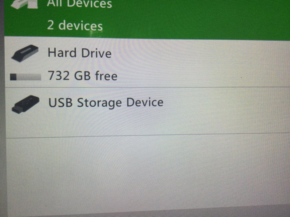

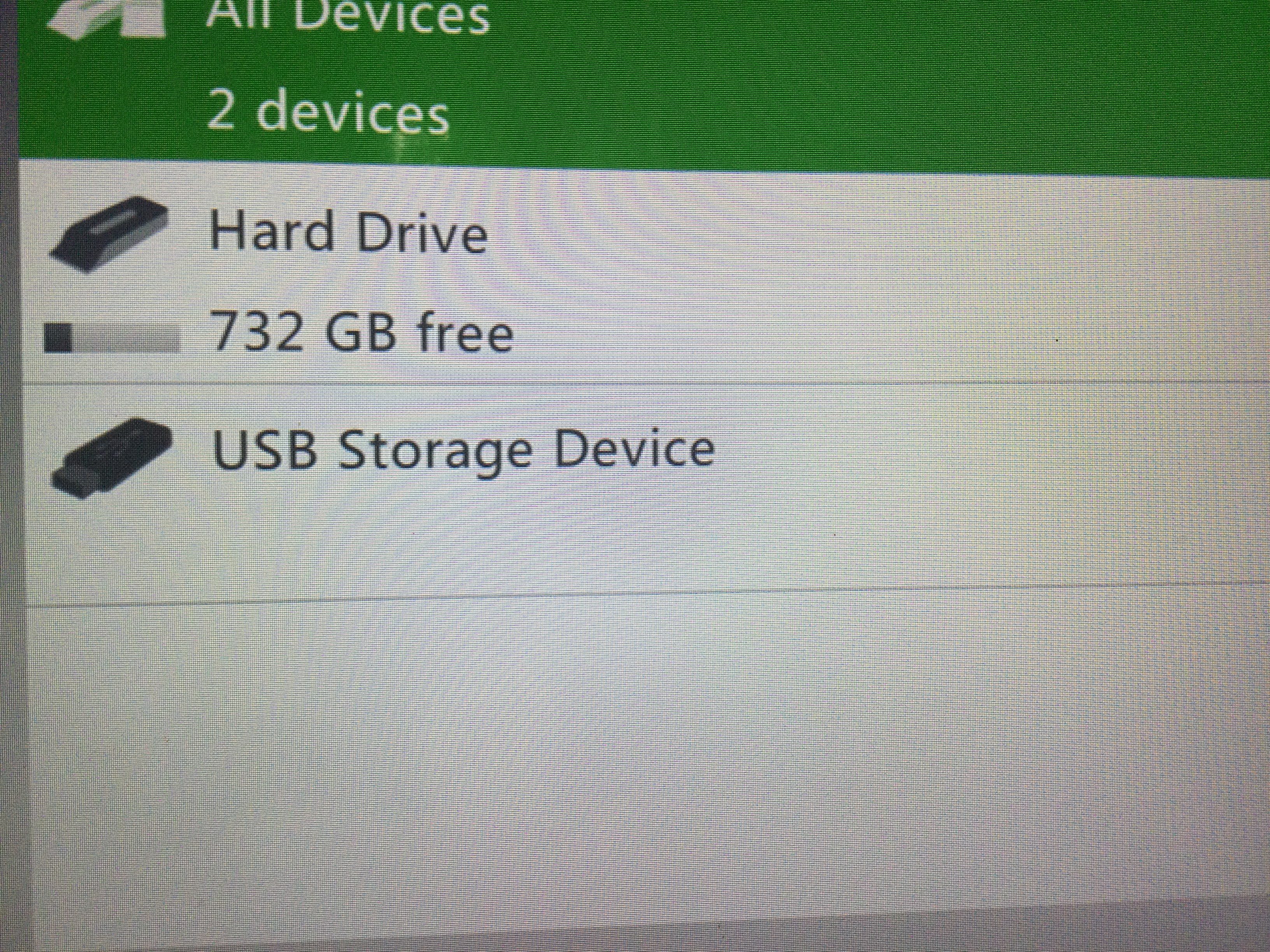

Neetsatou 0 Posted November 6, 2021 I am new to xbox modding. I got this xbox 360 from my brother. It is rgh modded console on dashboard 2.0.17148 . I was trying to install xex menu but usb won’t read it properly, I have attached photos of what’s going on. I have two xbox 360 console one is modded another is not. USB shows up properly on another console and xex menu also show up in demo sections but it doesn’t show up on modded console. Any help i can get is much appreciated. Also sorry if my English seems weird it is not my language. Quote Share this post Link to post Share on other sites
daniel_tobon 6 Posted November 7, 2021 You have to format the USB. I recommend you to backup any data you have there and then, press format USB. After that, you should be able to see it in Aurora or Freestyle. Quote Share this post Link to post Share on other sites
felida 1651 Posted November 8, 2021 update your RGH to 17349, and you wont need to format your usb stick.. ALL usb before this had to be formated to xfat... which your console is below.. i bet the other console is 17349 or above Quote Share this post Link to post Share on other sites
