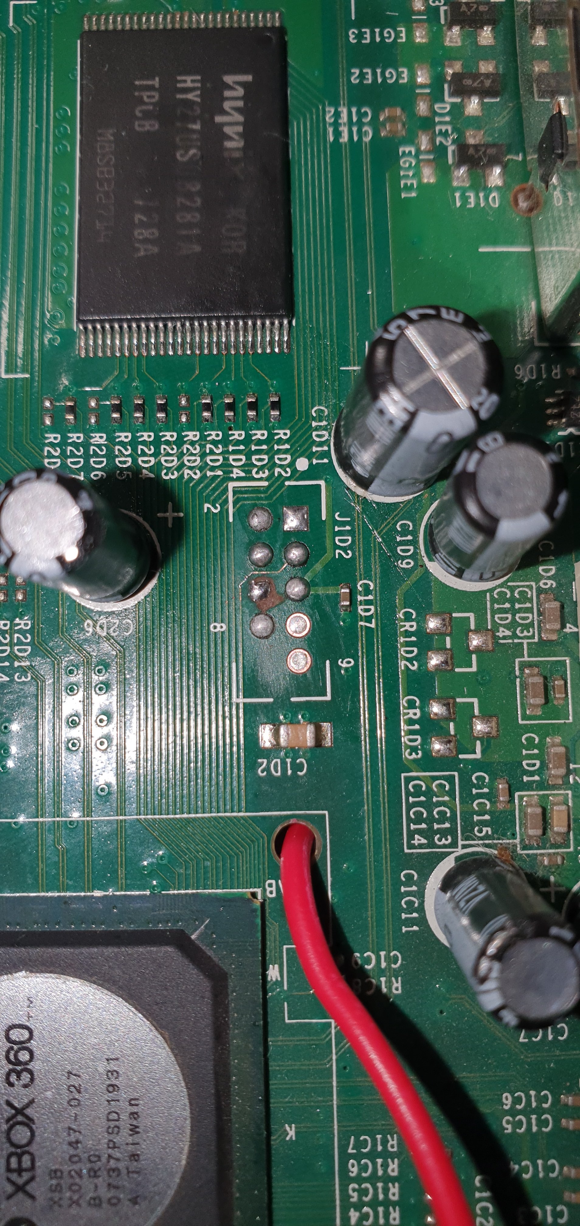

What is the alt points for nand reading on phat xbox for j1d2 points if anyone habe a pic maybe?
Got this xbox to jtag but point is damaged it seem.
Anybody got advice here would appreciate
The broken pad looks to still have solder inside it. You could solder to it still im sure. But that point is ground so any ground.
can confirm, just a ground point.. there is literally LOADS of spots you can solder to
Hi already fixed the console 2 days ago and figured it out jrp2 was the problem mainly wasn't connecting properly. But thanks
