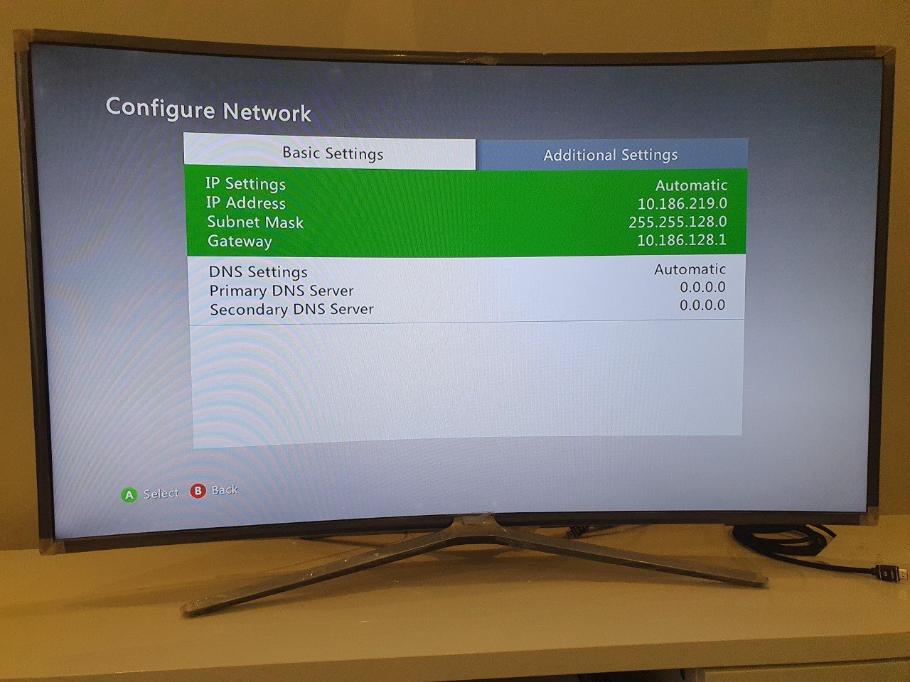

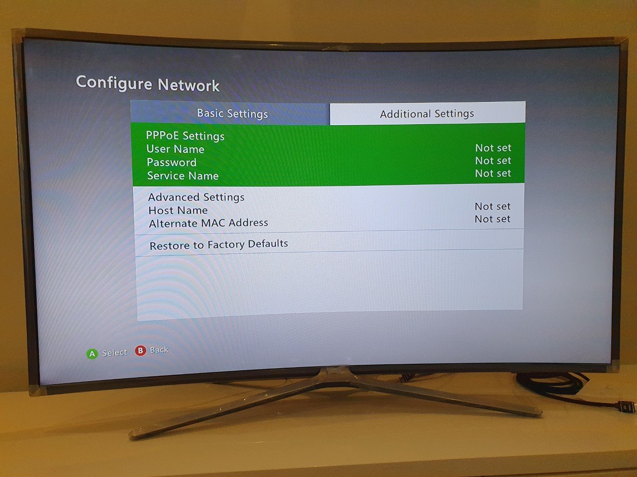

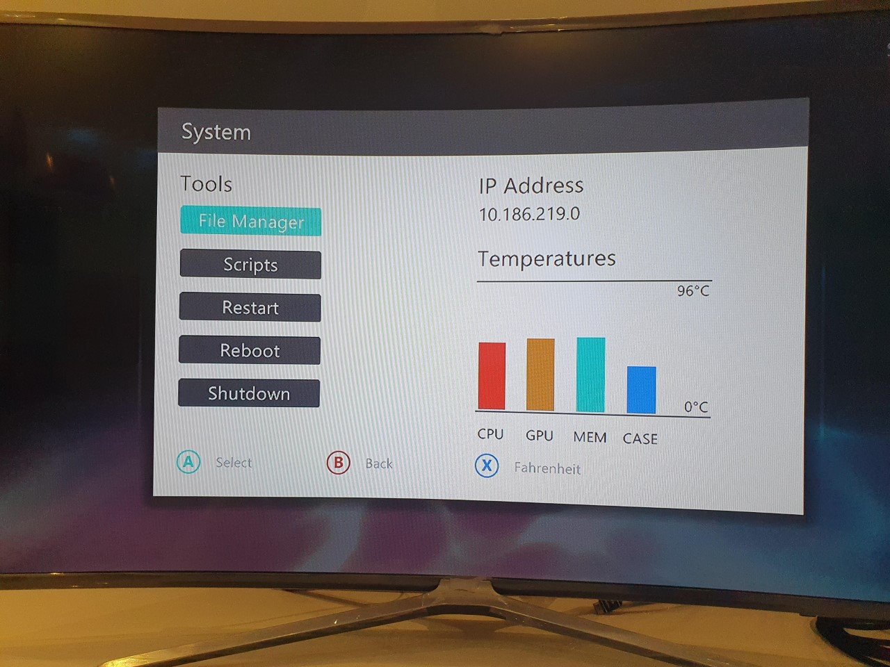

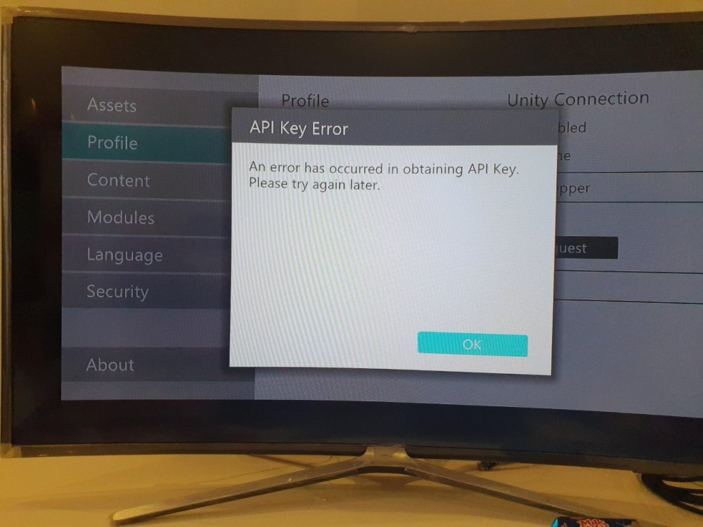

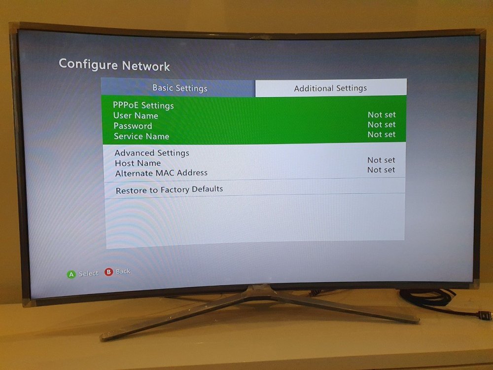

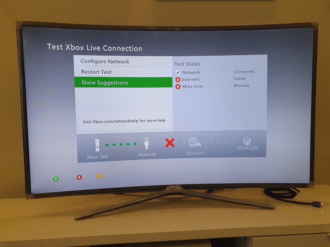

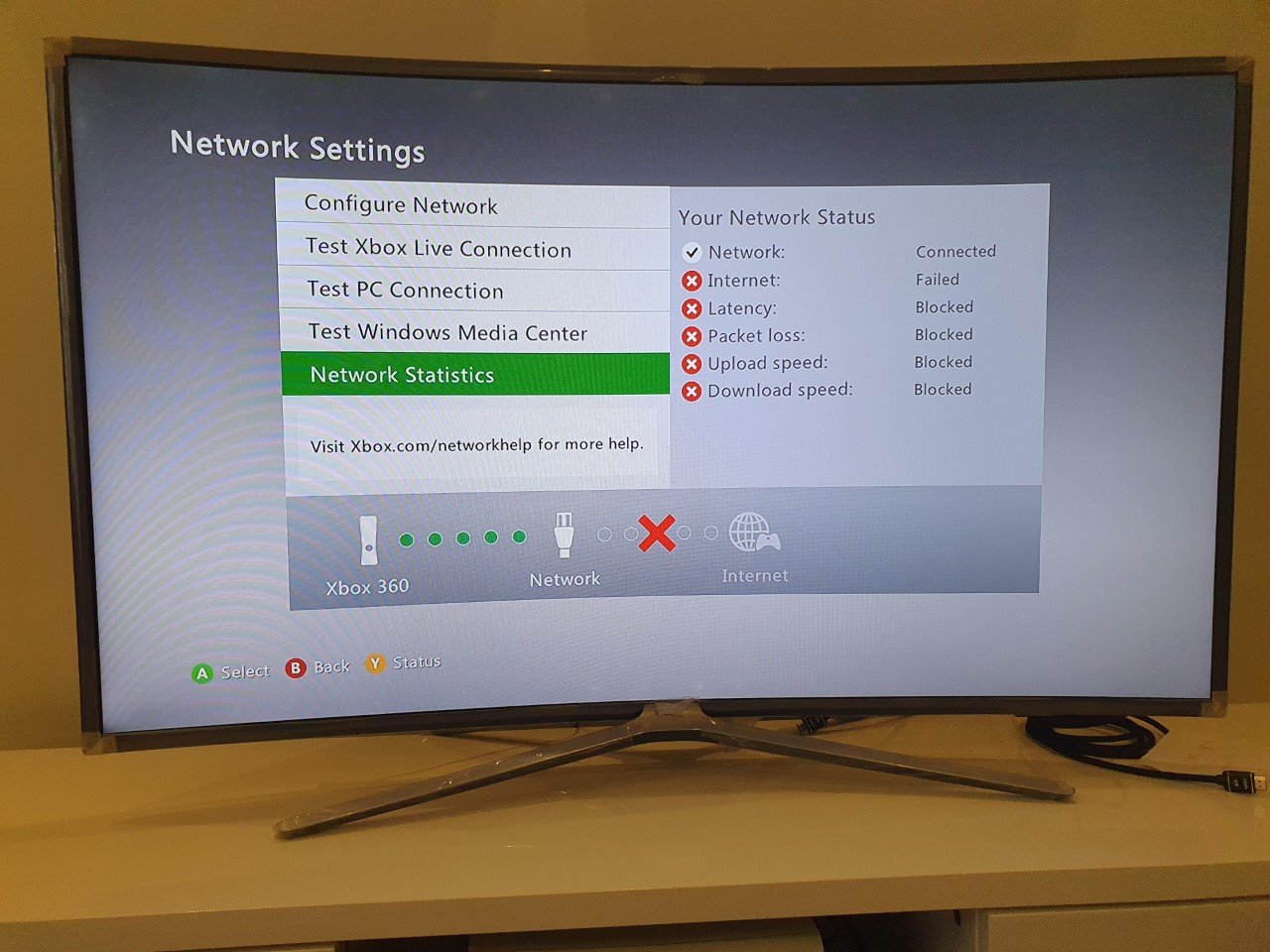

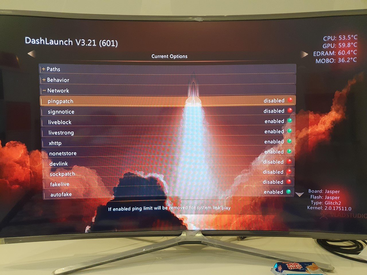

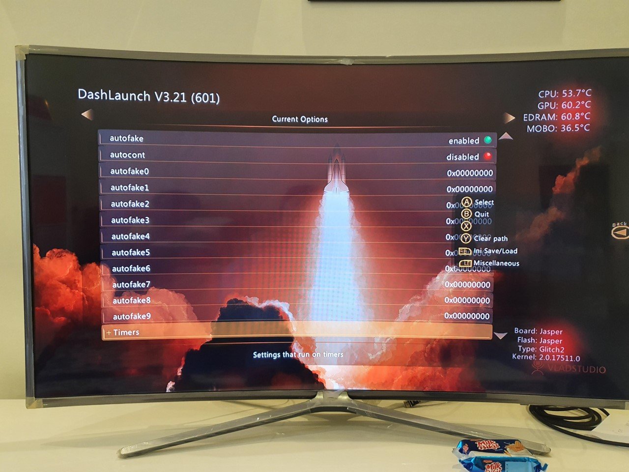

Abizer 0 Posted June 6, 2020 Dear all - I'm very beginner in terms of modding Xbox 360. I have a modded Xbox 360 (phat) which I got it modified from my local market (shopkeeper). Subsequently, I managed to install Xex Menu (working perfectly fine and managing to download games and play it via hard disk). Later, I installed Dashlaunch that is also working fine. Finally, installed Aurora and there I am stuck. It has been installed and it does launch perfectly. However, when I try to put my unity id and password it does not automatically retrieve the ID. I am able to use the same id and password on aurora via using a laptop. The photos of the error, dash launch settings, aurora settings and network settings are attached. Can someone look at it and tell me what I am doing wrong? Can someone please help to fix it? Thank you. Quote Share this post Link to post Share on other sites
derSammler 0 Posted June 6, 2020 I had the same issue when I did that on my 360 a few weeks ago. Just enter the API key by hand (you can see it when you log into the website) and wait some hours. It will work then eventually. At least it did for me. Quote Share this post Link to post Share on other sites
Abizer 0 Posted June 7, 2020 @derSammler: I did that and kept it as is for days, but I could not do anything on it like no cover download and etc. Quote Share this post Link to post Share on other sites

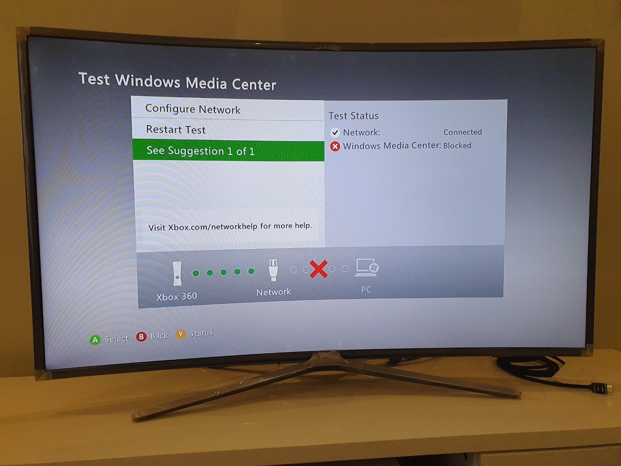

derSammler 0 Posted June 7, 2020 Make sure your 360 can actually connect to the internet, you may have a firewall blocking it. I'm a bit confused by the screenshots you posted. Some show internet and even Xbox Live, while others show no internet... Quote Share this post Link to post Share on other sites
Abizer 0 Posted June 7, 2020 @DerSammler: Yeah I know the screenshot for network setting is confusing. When I open network it shows all ticked but when I run the tests, results show different which you can see in the pics. How I make sure it is actually connecting to the internet and there is no firewall blocking? Quote Share this post Link to post Share on other sites
felida 1658 Posted June 8, 2020 14 hours ago, Abizer said: @DerSammler: Yeah I know the screenshot for network setting is confusing. When I open network it shows all ticked but when I run the tests, results show different which you can see in the pics. How I make sure it is actually connecting to the internet and there is no firewall blocking? Have you disabled livestrong? In dashlaunch?? And you do not use the built in network test, as it connects to m$ servers.. all you need to do is boot up aurora/xexmenu/etc and if you have an ip in their menus, you're connected, plus aurora will autosync the clock as well.. Quote Share this post Link to post Share on other sites
Abizer 0 Posted June 8, 2020 11 hours ago, felida said: Have you disabled livestrong? In dashlaunch?? And you do not use the built in network test, as it connects to m$ servers.. all you need to do is boot up aurora/xexmenu/etc and if you have an ip in their menus, you're connected, plus aurora will autosync the clock as well.. Yes, I did disable LiveStrong in Dashlaunch. It does show an IP address on Aurora but does not help in retrieving the key. Quote Share this post Link to post Share on other sites

felida 1658 Posted June 10, 2020 16 hours ago, Abizer said: Yes, I am entering a valid unity account. In fact I made two with doubt that probably one was case sensitive. Both perfectly works fine via the website using a laptop. Someone told me that I may require to port forward on router. Do you think that is require, if yes, how? Port forwarding is only required to host games on LiNK mate.. not to play/get tus and such..  Edit: Just noticed your IP address in the stock dash mate.. something really is messed up, because your gateway is 10.186.128.1 And your IP is 10.186.219.0  Logically this can not happen.. your IP to the Xbox should be 10.186.128.x (x = 2-255 if your DHCP is setup that way) Not 10.186.219.0  You have internal network issues, and that is why you can't connect to get your API key.. Quote Share this post Link to post Share on other sites
Abizer 0 Posted June 11, 2020 On 6/10/2020 at 11:17 AM, felida said: Port forwarding is only required to host games on LiNK mate.. not to play/get tus and such..  Edit: Just noticed your IP address in the stock dash mate.. something really is messed up, because your gateway is 10.186.128.1 And your IP is 10.186.219.0  Logically this can not happen.. your IP to the Xbox should be 10.186.128.x (x = 2-255 if your DHCP is setup that way) Not 10.186.219.0  You have internal network issues, and that is why you can't connect to get your API key.. I really do not know if that is internal network issues or what. Because I also have another xbox which is not modded and I easily connect that xbox on Xbox Live via wireless. Does my answer make sense? Quote Share this post Link to post Share on other sites
